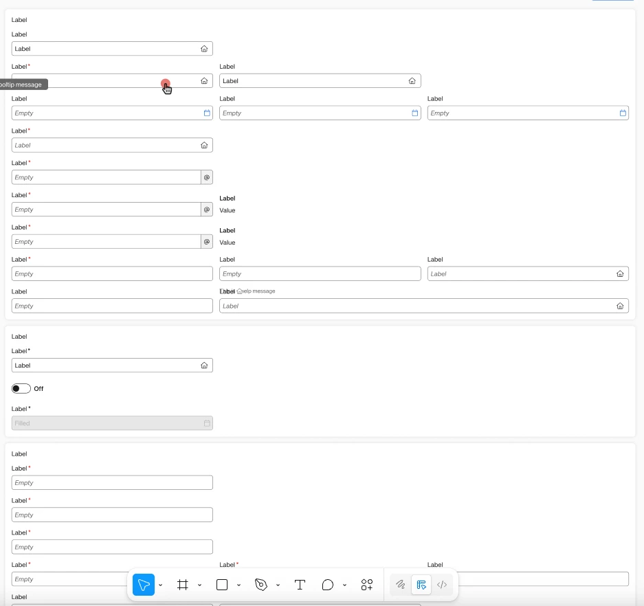

Ivan_Perez
August 22, 2024
I don’t know if this error is related but what happens to me is that i have nested instances inside other components and whenever i update some property on an instance it resets every property of the component, I don’t know if I have designed wrong the component and I don’t know how to solve it, it’s driving me crazy. 😩
