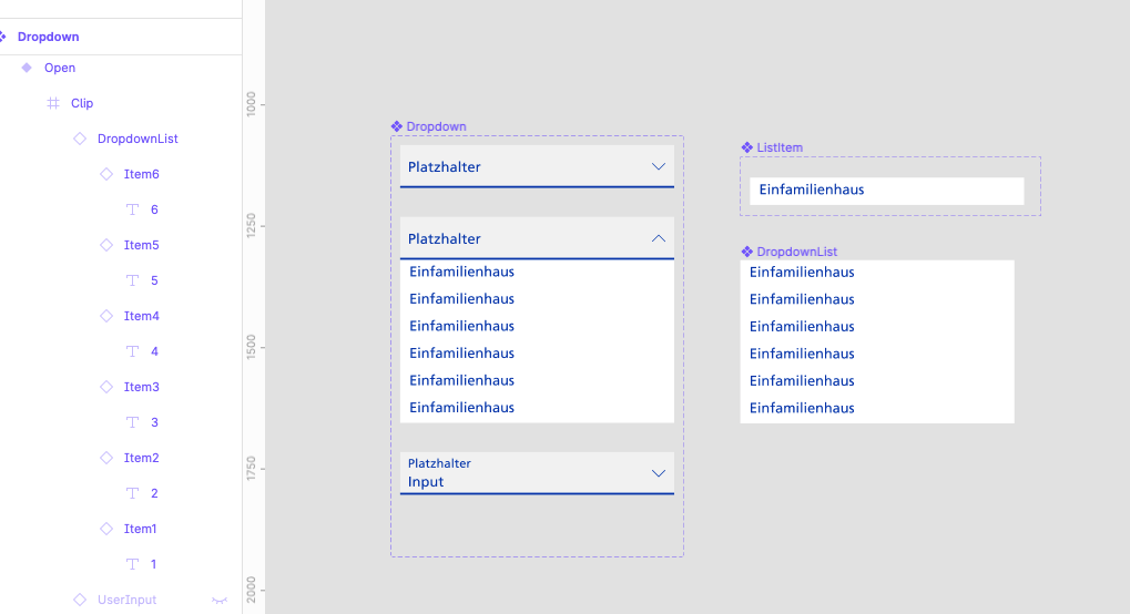

@jonoyoung Here is my file. I am struggling with the dropdowns. Thank you so much for looking into it! Ive been struggling for the last 3 days with it.

Daryna
  • 4 replies
  • November 3, 2021
@jonoyoung here is my naming inthe component. I have problem with Dropdown List only.
jonoyoung
  • 34 replies
  • November 3, 2021
What is the # Clip frame for?
It is hard to see the problem from the screen grabs.
Try renaming DropdownList > Item6 > 6, DropdownList > Item5 > 5, etc as:
DropdownList > item > text, DropdownList > item > text, DropdownList > item > text, etc. so each layer is named the same.

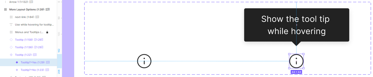

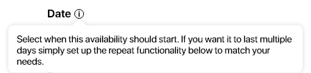

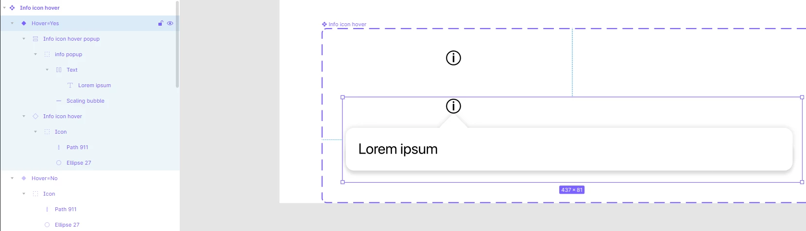

Omar_Chelbat
I’m having the same issue.
We use a simple hover info icon with a text bubble tooltip. Whenever I copy/paste the interactive icon it resets the text to the default.
I can’t even get the custom text to show up in a prototype, even when just copy pasting the hover icon on an empty frame and editing the text.
Please fix this Figma team, we’ve been using this feature in Adobe XD for ages and it’s such a headache that we have to send the text in a separate document to our developers.

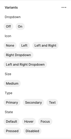

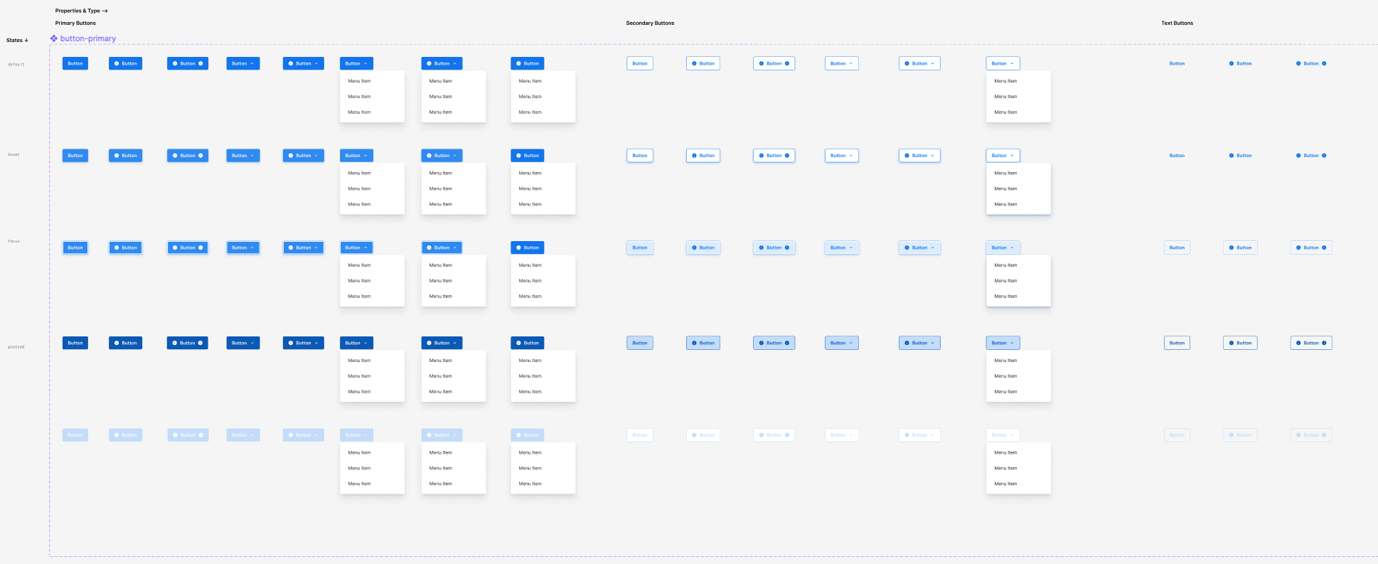

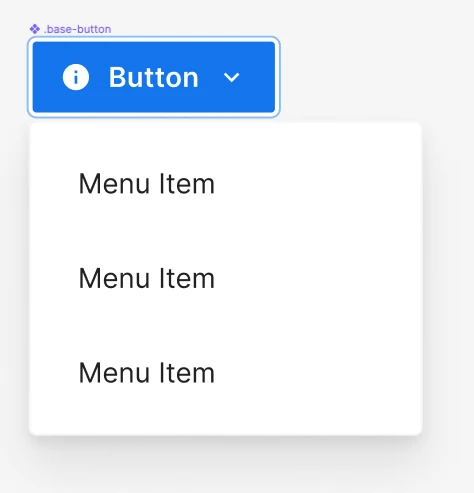

What @tank666 says is correct. If you are nesting a base component, that base component must have EVERYTHING that all of the other variants need to have.
This is my .base-button component:
Base includes all of the atoms that every other variant needs:
  1. Focus state
  2. icon left
  3. icon right
  4. dropdown menu

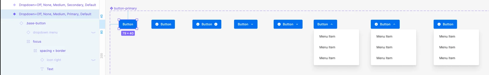

As you can see, when I nest the base component into my Variant, I am hiding all the atoms that I do not need to the default button state:
Here is my suggestion
Rebuild your base component with every single element/atom/state visible. Then, hide the elements/atoms/states that you do not need for each variant.
All Variants:
Variant Panel:

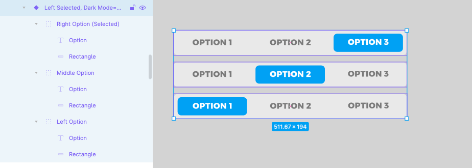

(Believe me) I have tried and am aware of the above .base method.
On complex nested upon nested variants, such as cards and heroes Text overrides still doesn’t retain changes at least in context of Dark mode toggles on/off in which they still stubbornly reverts back to whatever the “parent”, “master” or “base” component says.
I have spent days on this, frustrated.
If it were that easy as putting everything in their own “base” or “master” structure this thread would have been long solved. But the problem appears to be context specific. Sometimes text overrides does work, but in some cases doesn’t. Even if I adopt the above best practice in this case - putting everything diligently in their own master or “base” structures.
Or perhaps I’m just the “odd” one out.
Andrew16
  • 45 replies
  • November 10, 2021
Here’s a video I’ve uploaded (yt unlisted) on the problem I’m facing. Hope this resonates with someone else’s similar issues.

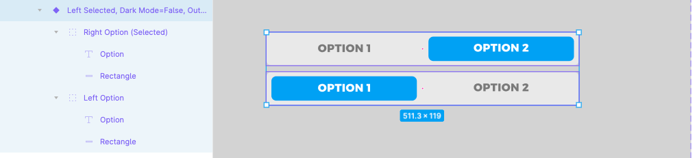

tank666
  • 4873 replies
  • November 10, 2021
@Andrew16, the structure of your variants is different, so text overriding doesn’t work. In the “Dark mode = True” variant, you have additional nesting, which is not present in the “Dark mode = False” variant.
I made a quick example similar to yours in which text overriding works.
Figma – 10 Nov 21
Andrew16
  • 45 replies
  • November 10, 2021
@tank666 - just want to say thank you very much for this much appreciated. It appears I have to be extra careful when it comes to setting up the nested components.
I was stuck in a prior workflow before having to create two (2) separate components (light and dark) and then merge them via “Combine as variants” feature. So that ~ it seems, Is the “wrong” way of approaching this…
Once again thank you for your help once again,

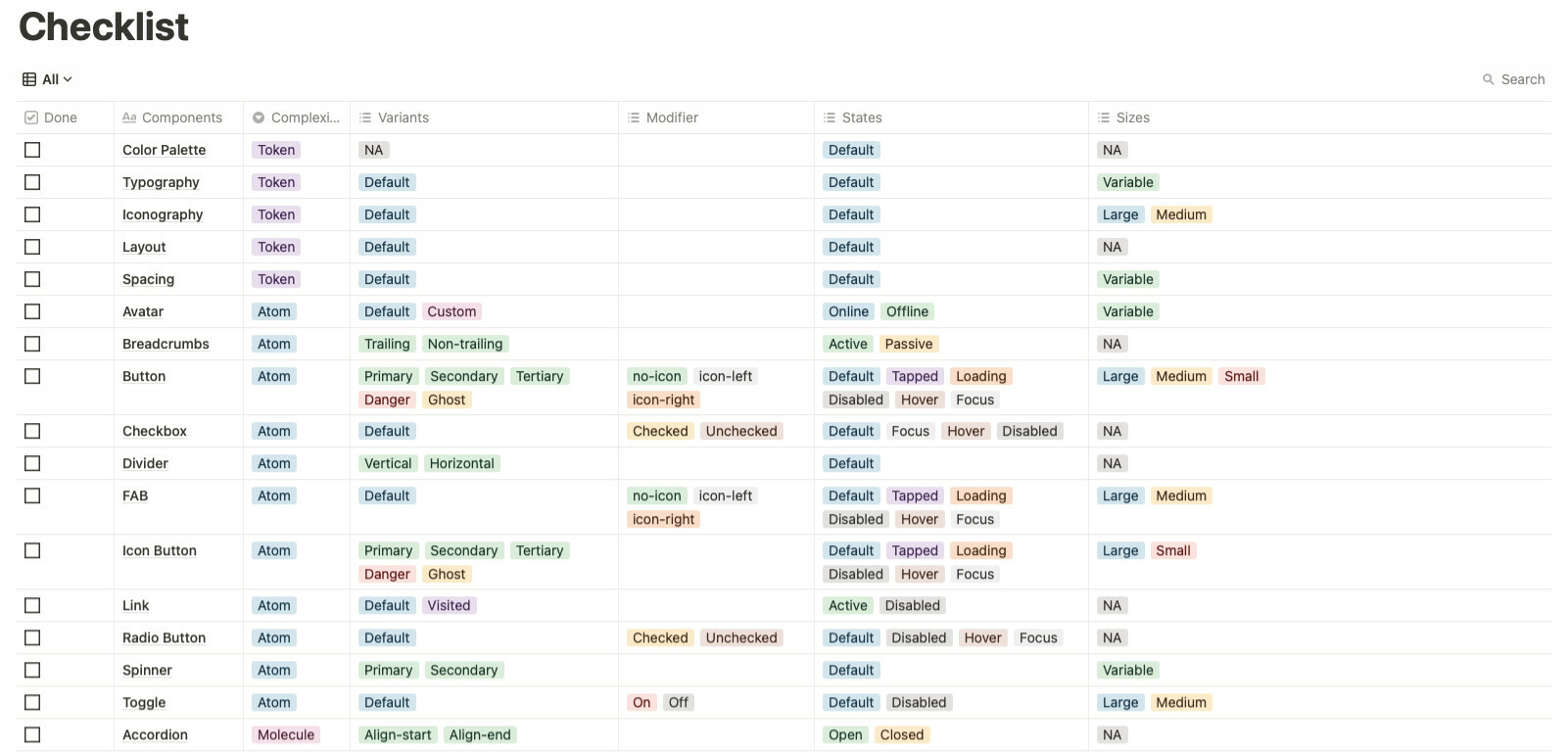

We are exploring the use of a spreadsheet to organize our Variant Properties, which also closely mirrors are Style structure, which also closely mirror our Event structure for analytics.
A colleague recently shared this checklist from Notion:
This is a way to keep things consistent from one component/theme to another.
Using a Google Sheet + Google Sheet Sync is a way to make this easy to access in your Figma files.

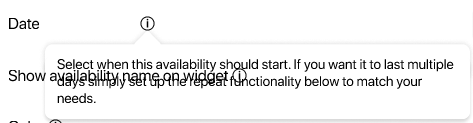

Omar_Chelbat
That did indeed fix the text problems! Thank you so much @tank666
Another issue I’m having is how these things are displayed when their size isn’t identical, even if auto-layout is turned off.
Here’s how it works in Adobe XD for an info icon with a hover tooltip:
Hover:
So as you can see it behaves like it would on an actual production web product.
Here’s the exact same thing in Figma:
Hover:
  1. Auto-layout layer order screws up any drop-down or hover designing you’re doing by forcing the layer order so that top items are “below” items below them.
  2. The item doesn’t retain it’s original position, instead the entire thing shifts.
That’s not how things work in real life products. This is just Figma being weird and restrictive on both accounts.
The only way to get around 1. is to disable Auto-layout, which is really damn stupid. 2. has no fixes afaik
tank666
  • 4873 replies
  • November 12, 2021
So that the object doesn’t shift, it must be the same size, that is, the size of the variant with the showing tooltip must be equal to the variant with the hidden tooltip.
jonoyoung
  • 34 replies
  • November 12, 2021
@Omar_Chelbat this part of Figma Interactive Component video addresses your tool tip question:

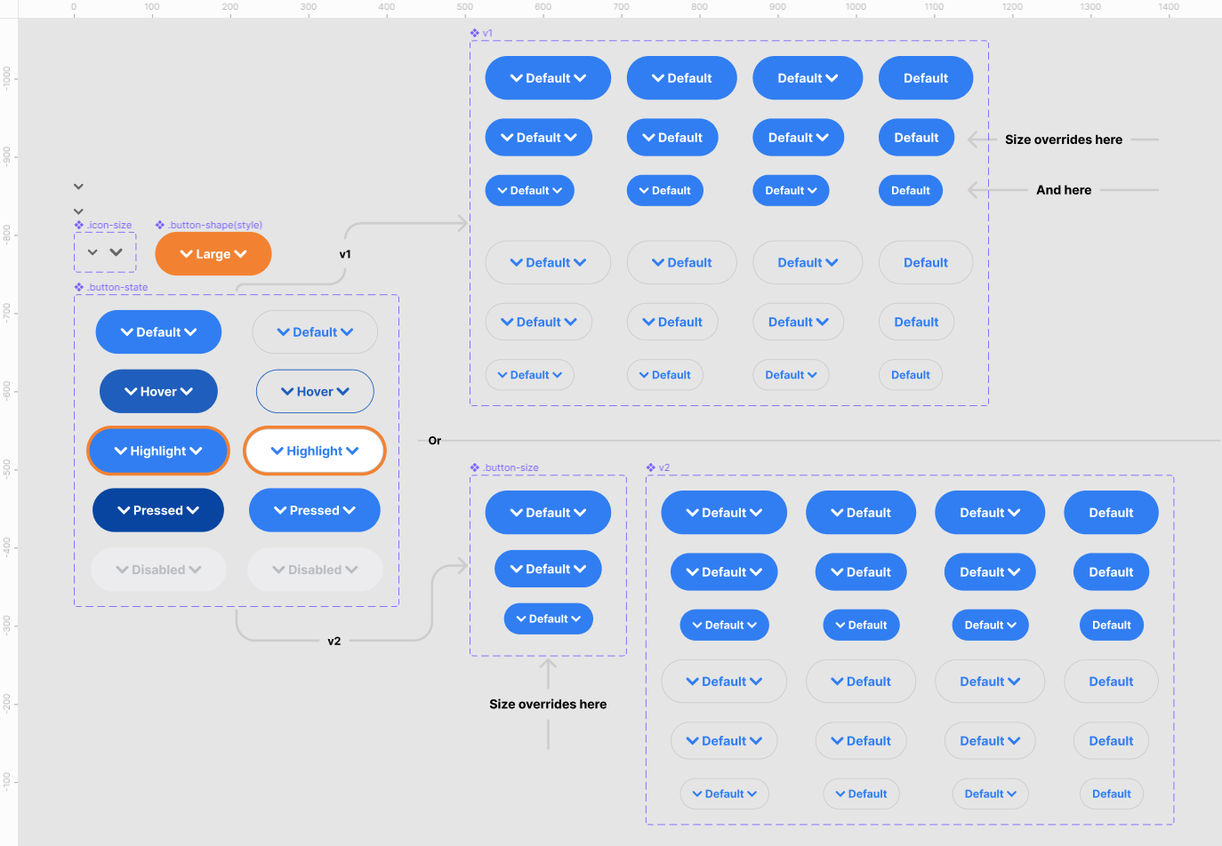

  • 4873 replies
  • November 16, 2021
Thanks for the link! I’ve experimented with your file and here’s what I can guess. The overrides were breaking because Figma doesn’t know how to define the state.
In your example, it read like this: “Any button with/without icon should be large and in the Default/Hover/etc state, and any size, and with some style”.
And it should be something like this: “Any button with/without icon and any size should be in Default/Hover/etc state with some style”.
I hope you understand what I mean.
