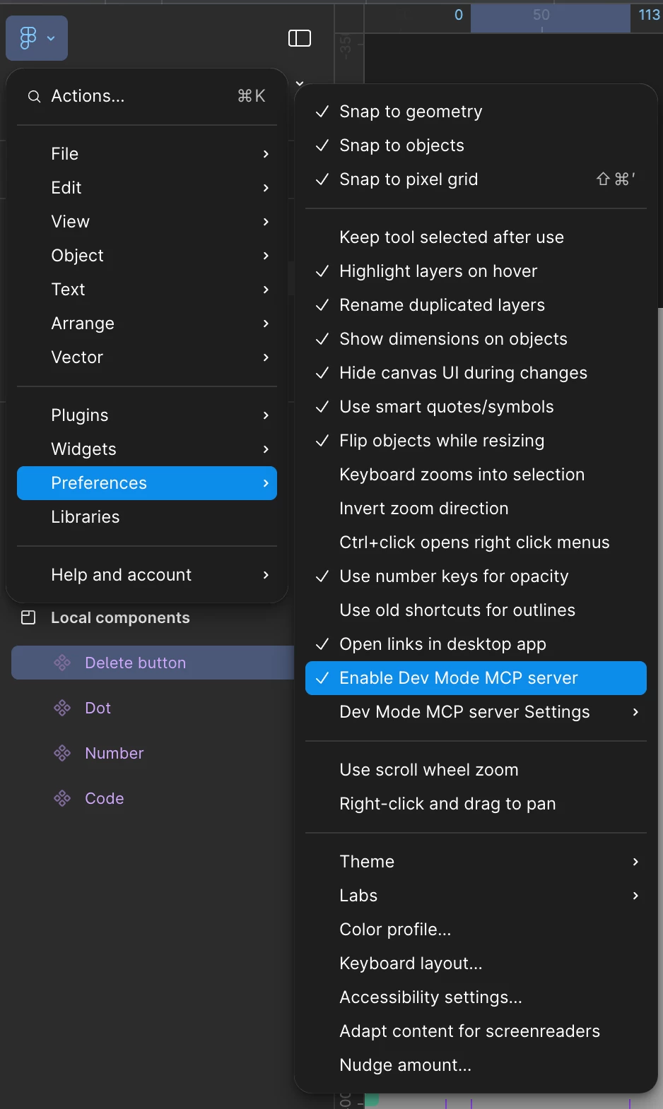

For additional info, I am running the Figma desktop app in the background, with it seeming to be properly configured.
Figma.app

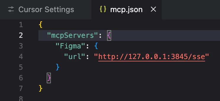

Cursor’s mcp.json

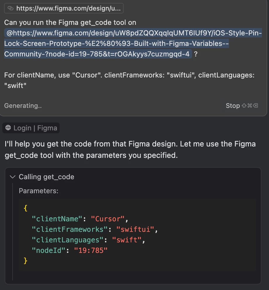

It hangs here.

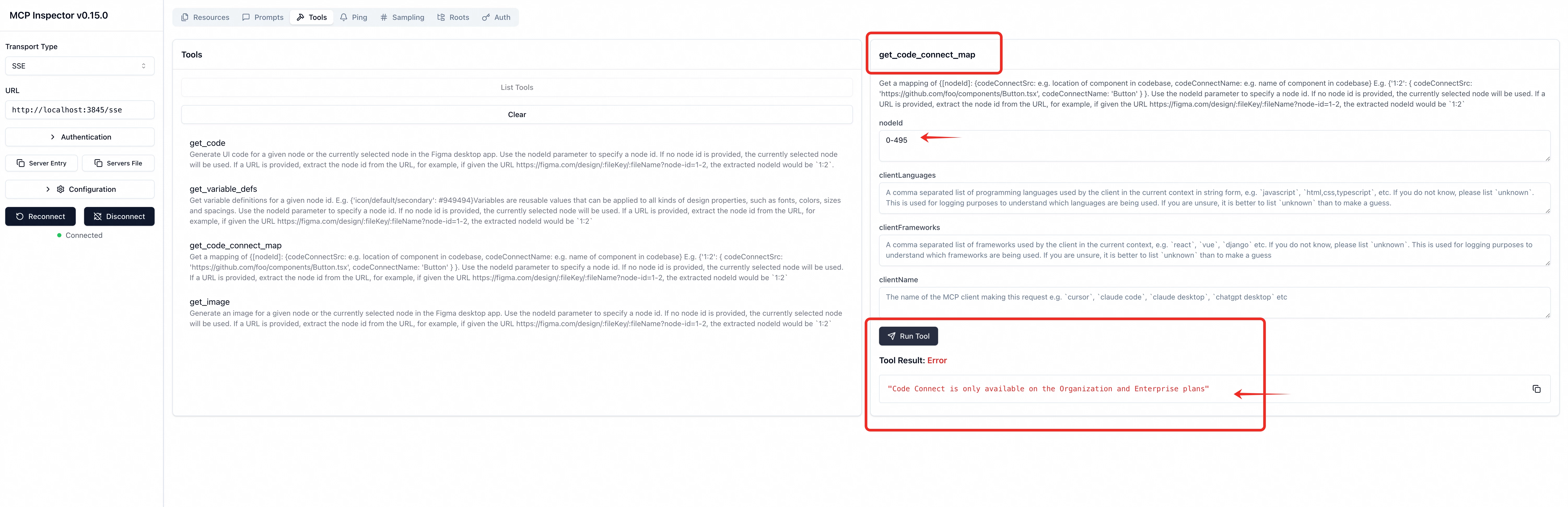

I used MCP inspector for debugging.
The "get_code_connect_map" function indicated: "Code Connect is only available on the Organization and Enterprise plans";
The "get_code" function indicated: "MCP error -32001: Request timed out"
