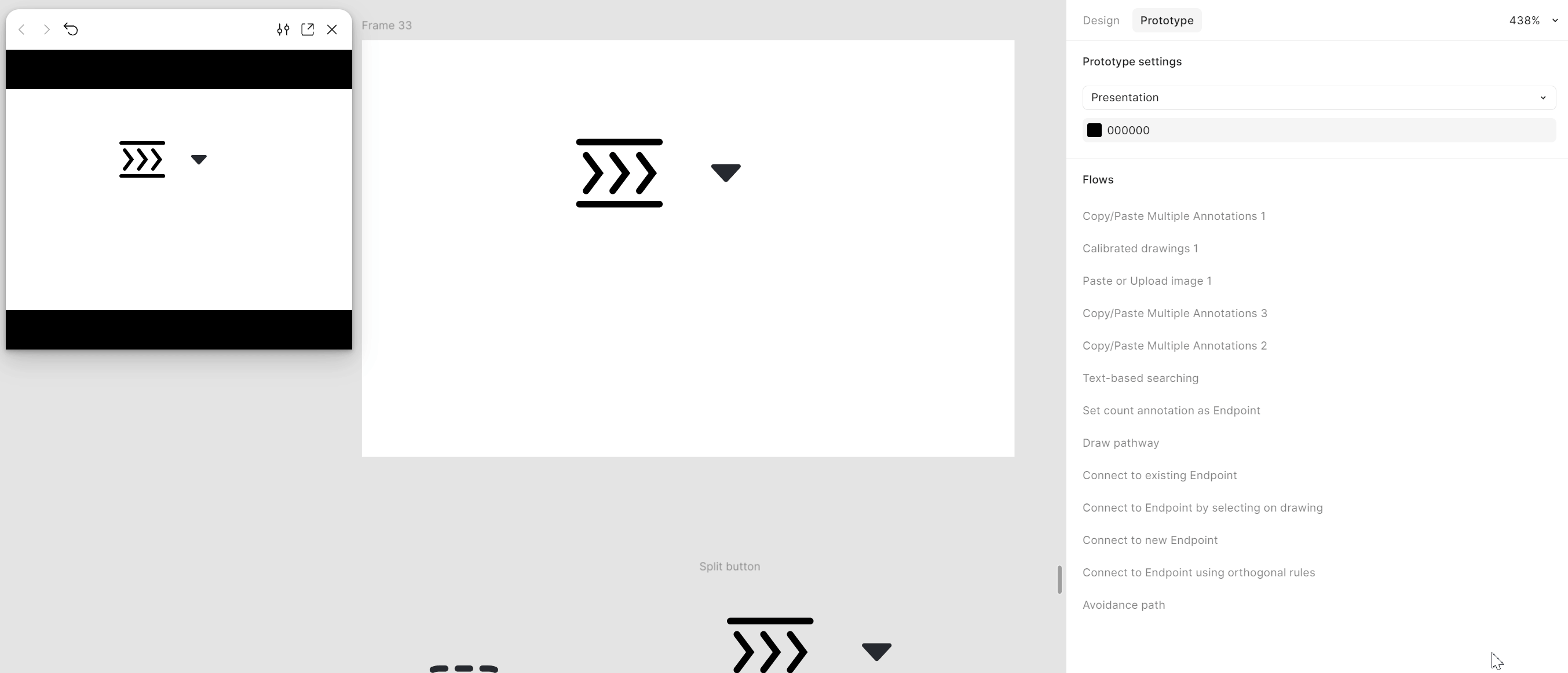

This GIF shows the issue in real time. The nested component interactions are still present, but are hidden/disabled when nested inside a parent component. Detaching the instance of the parent shows that the interactions are still there.
This has to be a bug, right?

Hey All, thank you for your feedback!
To be transparent, I flagged this to our team and they confirmed that this is expected behavior. We don’t support interactive components inside of main components that are directly integrated into frames.
The team is now aware of this feature request and will continue to monitor it for future consideration.

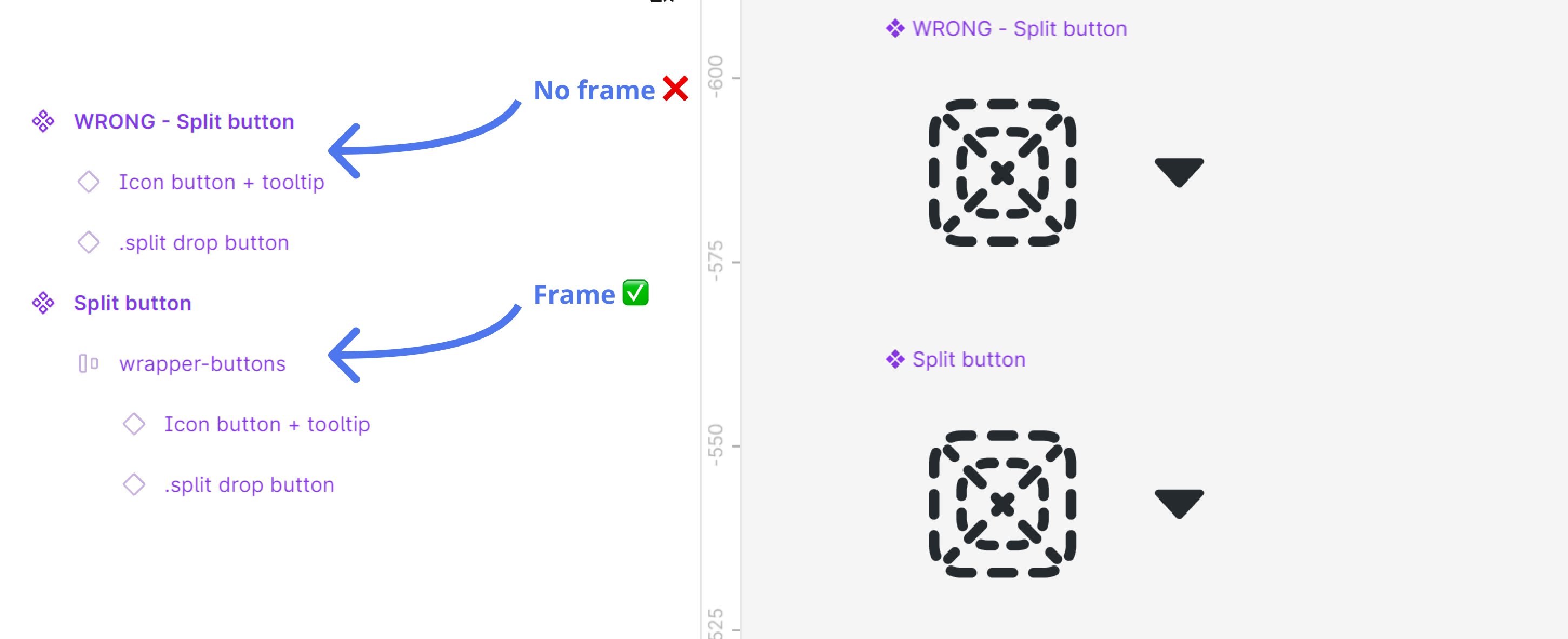

Zach_Ward2
  • New Member
  • 5 replies
  • June 25, 2025
For those of you struggling to understand the workarounds like I was...
The simplest solution I found was to wrap the nested components that have the interactions in another frame.
