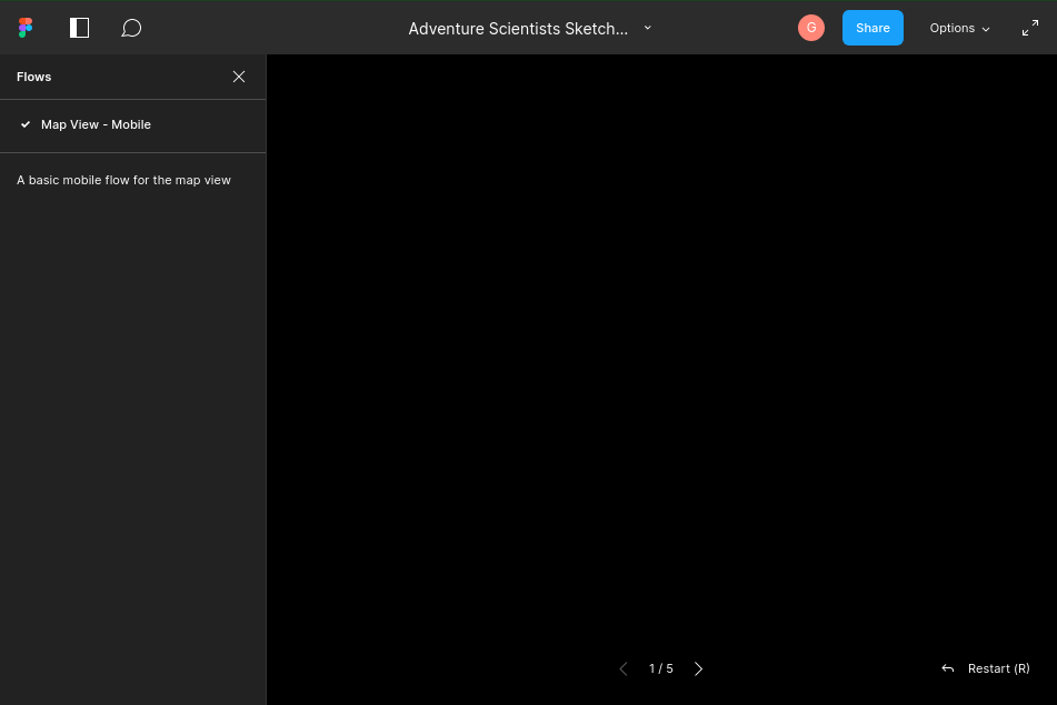

Hi there,
I’m a new Figma user, and loving it thus far. However, I can’t seem to get prototyping to work at all for my complex project, even though I can get prototyping working on a “hello world” project. Here’s the symptoms I’m seeing.
1 - I set up a flow (with let’s say N steps)
2 - I press the prototype button, and it takes me to a screen (screenshot below), which always has the same N as the number of steps in my flow (telling me something is still working).
3 - However, the content never loads - it’s perpetually a black screen.
Looking at the network log, I see all of the assets associated with my project (images, fonts) loading successfully, but none of the “core” data of the page (I couldn’t for example find a string on the page in the network logs). I also could be missing this if it’s encoded.
In the developer console, I see two things that may point to an answer. A request for (what looks like a script needed by Figma called imagecoder) returned a 404, and shortly thereafter some minified javascript got an null error when trying to use it (if I’m de-minifying correctly).

Also! I’m sorry I didn’t mention this in the initial report, but I replicated the same behavior on a Mac. Both browsers were up-to-date Chrome.

Hi! I’ve found the source of the error. It wasn’t what I suggested above, it was a strange behavior with an accidental box shadow:
