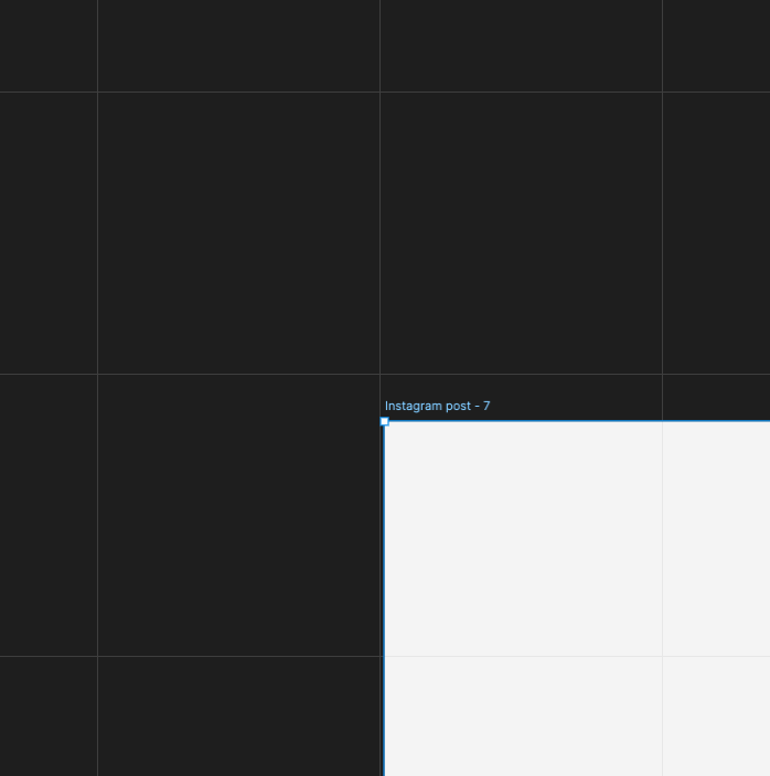

I understand the problem.
The reason your exported file has some additional pixels, even with "Clip Content" enabled, could be:
  1. Your frame/object has some unwanted effects applied.
  2. Your frame/object is not aligned to the pixel grid. Try zooming in on the left corner and snapping it to the grid.
  3. Your frame/object does not have rounded dimensions. Even small decimal values can cause rounding issues and add extra pixels.
I hope this helps!
