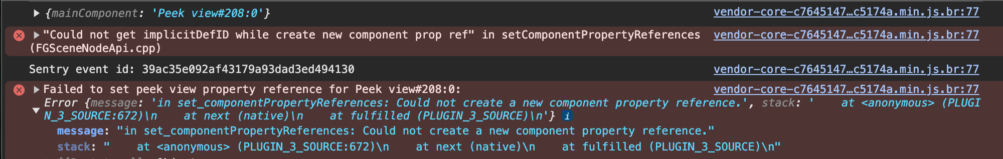

This generates a log message showing that (I think!) the new property references are correct:
"mainComponent": "Peek view#208:0"
But the assignment fails and throws this exception:
"message": "in set_componentPropertyReferences: Could not create a new component property reference."
