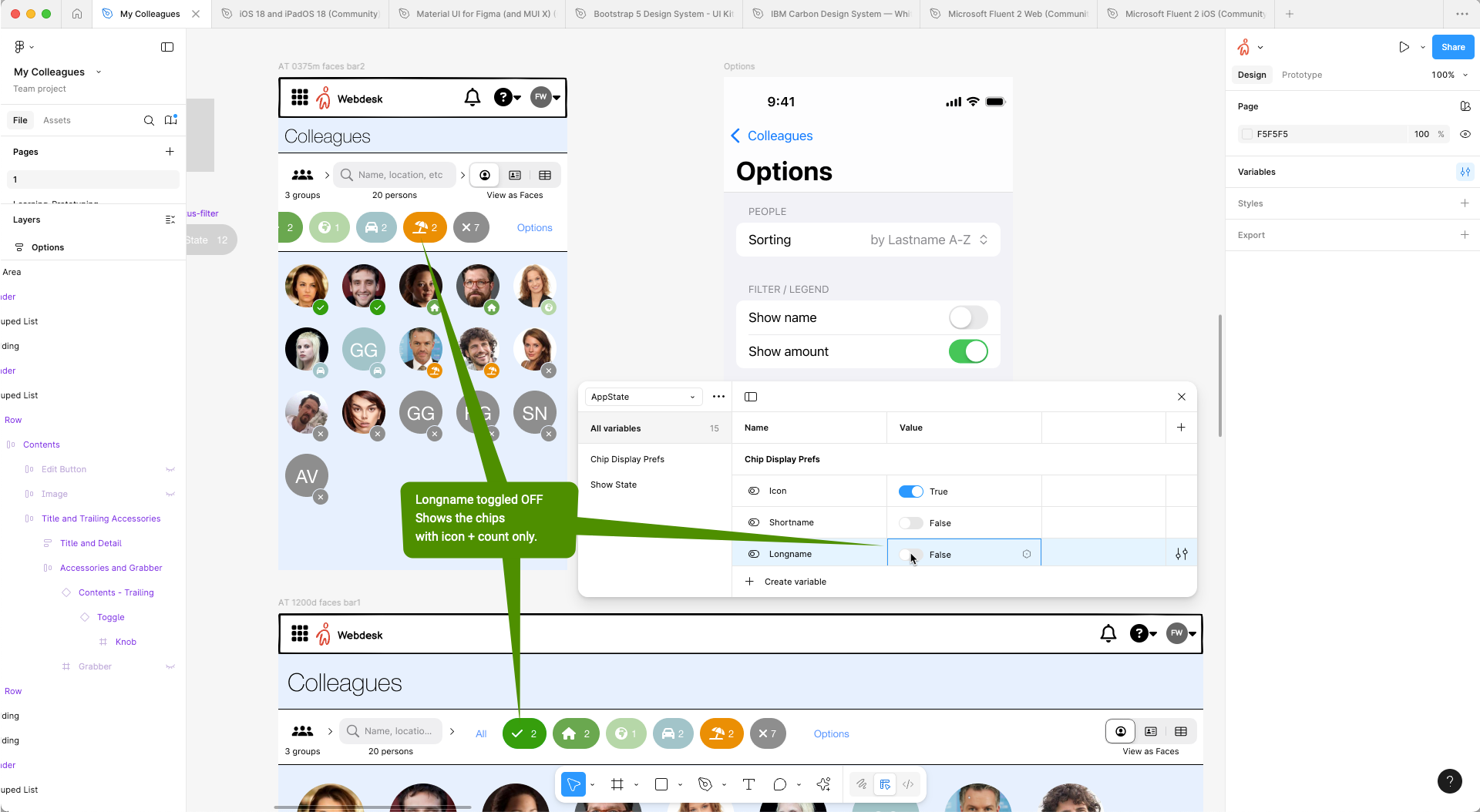

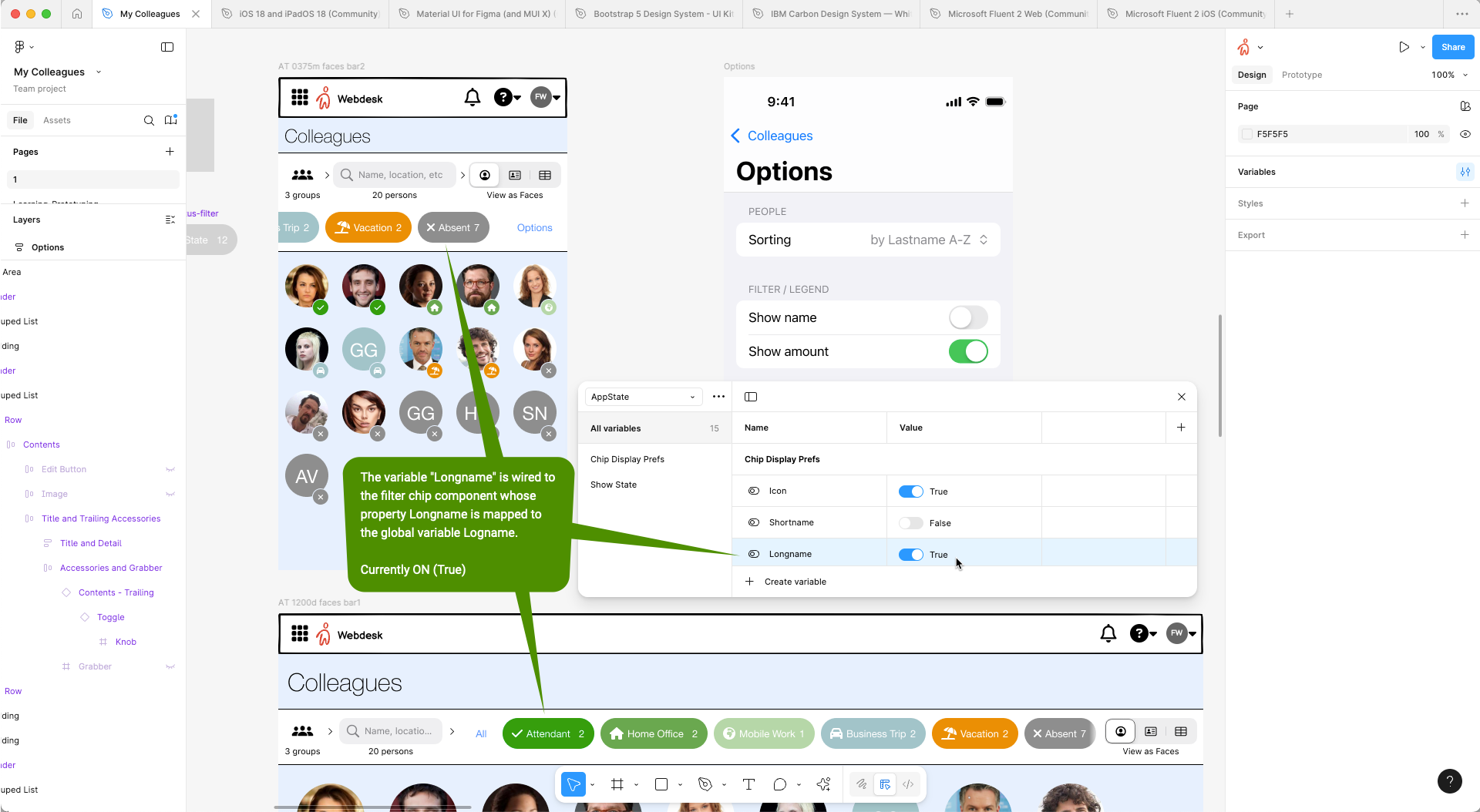

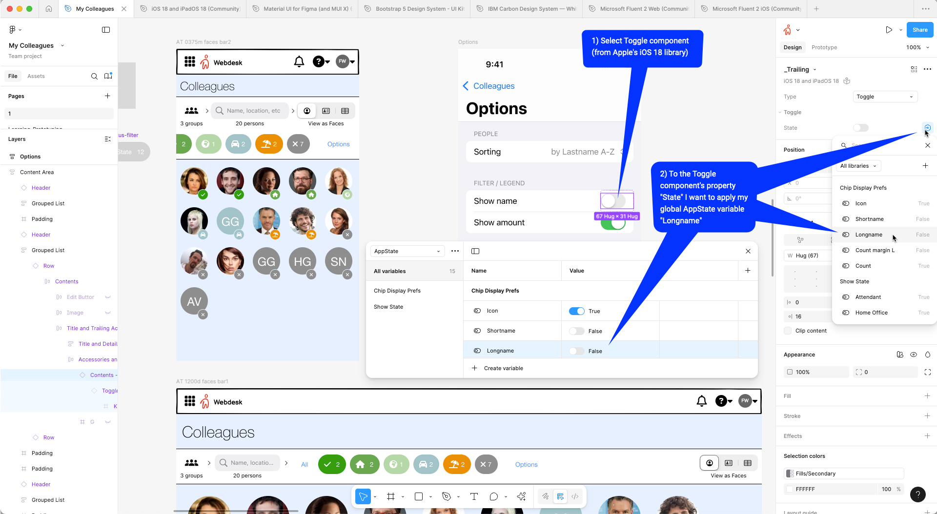

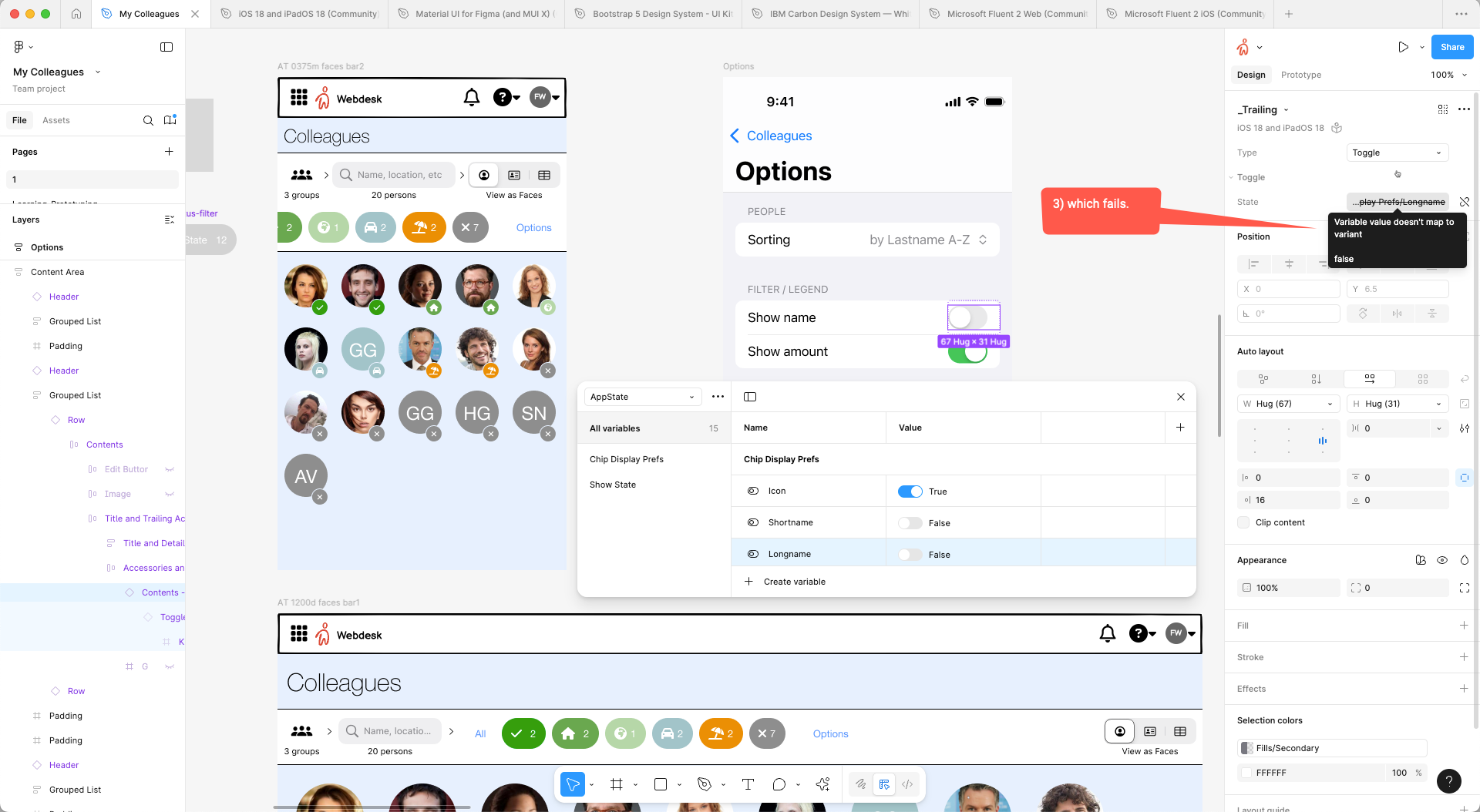

Linking my boolean variable /AppState/Chip Display Prefs/Longname to the Toggle component from Apple’s official template iOS 18 and iPadOS 18 fails with  Variable value doesn't map to variant  false which is a shame because:
  • It’s a template from a big name (Apple)
  • officially shipped with Figma
  • is a component from which you expect this mapping to work: toggle switch with two states ↔︎ boolean variable. Seems an ideal match. What could go wrong?
@Figma: Please fix this!

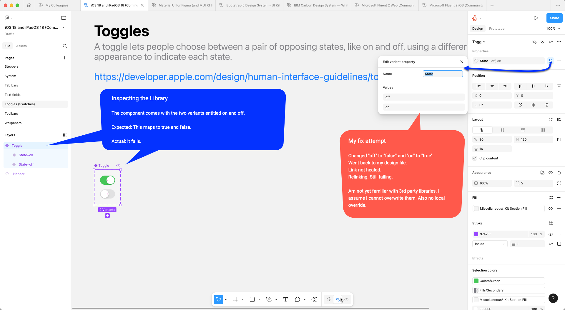

@Community: My fix attempt to replace on/off with true/false in the 3rd party library failed. I guess this does not get persisted (do not know library feature yet). Any workaround/hints?

My workaround was:
  • Open 3rd party library iOS 18 and iPadOS 18
    • Select Toggle component
    • Copy it into clipboard ⌘ C
  • Go to my design file
    • Paste ⌘ V the Toggle component there.
    • Rename it to clearly indicate its a derivation, e.g. “Toggle-Adapted”.
    • Change the property variant names from “on/off” to “true/false”.
    • Create an instance somewhere on canvas, select it, copy ⌘ V.
    • Select the components (list entry + its toggle) and use command: Detach instance ⌥ ⌘ B .
    • Select the toggle (now a standard object, no component anymore).
    • Paste to replace ⇧ ⌘ R the detached toggle with the instance of your fixed toggle component.
Then I could apply my variable “Longname” to that toggle property “State”. And I now have a working interactive prototype.
This is ofc only a “dirty workaround” because that list iOS entry is now not getting anymore updates should the library update. But it’s good enough for me for now.
