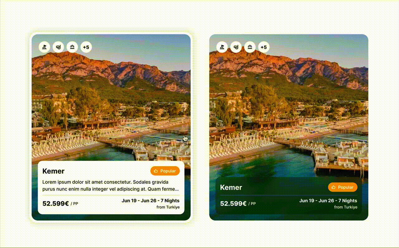

Hello everyone,
I’ve run into an issue in Figma prototypes: whenever a component has a Background Blur effect, Smart Animate stops working correctly. I’m looking for any known workarounds or explanations.
Scenario
  • A Frame/Component includes:
    • A semi-transparent fill (e.g. white at 20% opacity)
    • Background Blur effect (Radius: 20px)
  • I use Smart Animate to transition this component between different states (variants, interactive component states, or separate frames).
Observed Behavior
  • Without blur (same component with only an opaque fill and no blur), all Smart Animate transitions run smoothly.
  • With blur applied, Smart Animate transitions:
    • Jump instantly without interpolation,
    • Or fail to animate entirely.
Questions
  1. Are there any known Figma limitations or bugs when using Smart Animate on layers with Background Blur?
  2. How can I achieve smooth Smart Animate transitions on blurred components without relying on masks or overlays?
  3. Could there be a prototype setting or component hierarchy detail I’m missing?
Is it possible to have native, smooth animations with Background Blur + Smart Animate? Thanks in advance for your help!

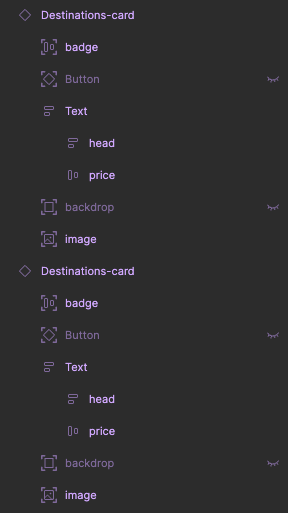

Hey ​@burak.koc — thanks for flagging this, and for laying out your setup so clearly. I like this concept!
Based on your description (without seeing the file directly), here’s what might be happening: Figma Design does support smart animate on layers using background blur, but noise effects are randomly generated. To help ensure smart animate runs smoothly, the recommendation is duplicating the frame so the layers are identical. If they’re not, Figma may default to a dissolve transition instead. You can find more details here: Smart animate layers between frames → Fill.
Does duplicating the frame help unlock the effect you're aiming for? If not, it might be worth having our Product Support team take a closer look. You can reach out with:

burak.koc
burak.kocAuthor
Jun 24, 2025 8:41 AM UTC
Thank you for your insight!
I’ve followed your advice: I duplicated the exact frames that worked without blur, then simply changed the fill across all variants and added the Background Blur effect. Unfortunately, this isn’t limited to just that one card—I’m seeing the same breakage on any component where I apply blur.

Felix_Dorner
Jul 2, 2025 6:50 PM UTC
Same for me. Moving in an object with background blur via Smart Animate results in:
  1. Animation is played without the bg blur
  2. When animation is done, the bg blur is appearing instantly
