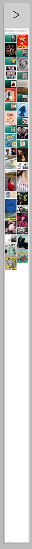

Is anyone else getting Sites pages cut off arbitrarily at the bottom when publishing?
I’m sure that the page is extended to include the entire design content of my pages, but when I publish, some of them are fully viewable and others I can’t scroll to the bottom of them! Sometimes it’s just a little bit, and other times it’s a good 200px worth of content.

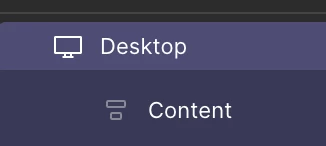

This is happening to my Figma Site as well… It’s showing fine in ‘full preview’ on Figma. But after I published the site, the bottom part of the site gets cut-off..
Edit: The full preview looks fine in the 1280x752 view-point but once I extend the width to more than 1280, the bottom part of the site gets cut-off…
Edit 2: I fixed it. I selected the ‘desktop’ frame, at the right side-bar, select ‘height’, select ‘hug content’. Now my content doesn’t gets cut off anymore.

Hi to both of you, thanks for responding! Unfortunately, there’s no ‘Hug contents’ on the Height for Desktop/Tablet/Mobile for me. My only option is Fixed Height; Fill Container is grayed out because that obviously doesn’t make sense...
I’m still having the problem, but I tried adding a Max Height to see if that would force it to extend. Still checking as I’m getting inconsistent results.

It seems that the browsing window size matters. If it’s smaller (width wise) I can see the bottom of my published pages, but if I go full screen and use the full width of my monitor, it cuts off the bottoms at arbitrary levels. This also applies to Preview in my case. I can’t figure out how to fix it. :(  ​@Tom Reem

I am suddenly having this issue again on my website. I initially managed to resolve it with the advice from ​@Jonph a few weeks ago, but since updating new Figma sites, it’s reverted to cutting off again. The desktop frame still has ‘hug contents’ selected in height, but it still cuts off when published.

I just connected with our Technical Quality team, and they’ve escalated this to Engineering. I don’t have a timeline to share yet, but in the meantime it would be helpful to know if the solution uncovered earlier by ​@Jonph is still working for others:
