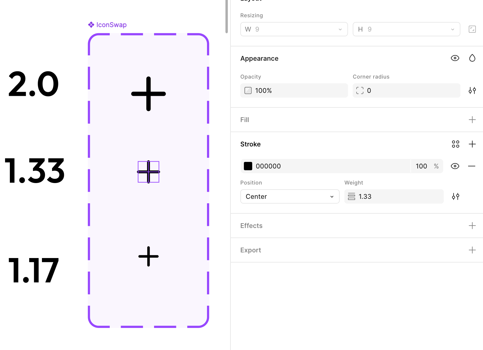

I found an interesting work-around for this
Was using the Lucide icon kit, which uses strokes for all the lines. By default they came as 24px, but I needed various icon sizes for the different size buttons. After adding icons to the buttons, whenever an icon was overridden with a different variation the stroke would reset.
I tried many different variations and finally what worked was to create an intersticial component that contained instances of the icon but at different sizes and stroke widths. I determined what the stroke should be scaled to…
24px Icon = 2px stroke (default from icon kit)
16px Icon = 1.33px stroke
14px icon = 1.17px stroke
By manually overriding the strokes of this icon component and THEN embedding in the button component, my instance swap finally maintained the stroke width.
