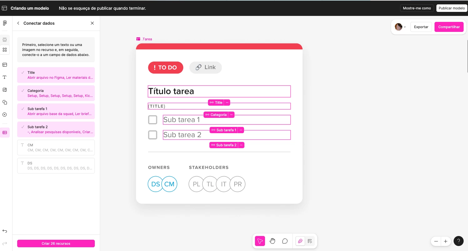

Hello,
I’m facing the same issue. I’m testing the Bulk feature, but it’s not working. It’s just duplicating the original layout.
That’s what I’m doing:
Uploading this simple sheet:
Mapping:
But when I click to create, this is what happens:
Am I missing something?
I’ve already check for Figma Updates and installed them.
Thanks!
