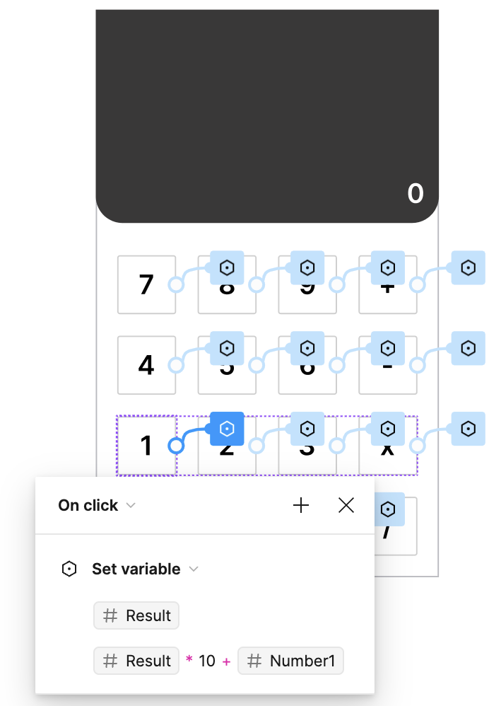

I am trying to create a basic calculator using Figma variables.
The calculator has 1-9 number keys and a result section linked to number variable #Result
Interaction on numbers takes place as follow:
Interaction logic:
Prototype mode: On clicking 7 multiple type result displayed is as follows:
Expected: 0, 7(0x10+7), 77(7x10=7),777, 7777, 77777, 777777,
Unexpected: 77777776, 777777792, -2147483648 (and stops)
Can anyone help me with the reason for this error, as I have rechecked all logics carefully.

The unexpected results in your Figma calculator (like 77777776, -2147483648) are likely due to integer overflow. When you keep multiplying the result by 10 and adding digits (e.g., Result * 10 + 7), the number quickly grows beyond the 32-bit integer limit (2,147,483,647), causing it to wrap into negative values. To fix this, treat the result as a string and use string concatenation (e.g., Result + "7") instead of arithmetic. This approach also mimics how real calculators display inputs. If you're building tools like this, you might enjoy designing a CGPA calculator as well—similar logic, but more academic use. Let me know if you'd like help with that too!
