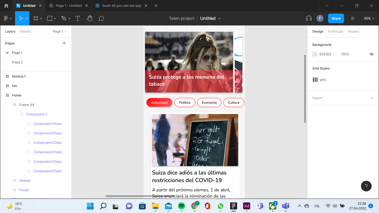

I cannot make my screen scroll to and in turn, change the “component variant”.
My idea is to scroll from one frame to another and have the appropriate section button selected. The problem is that although I have created the variations of the c
components when I want to add more than one interaction I get the following error:
“This interaction will not be triggered as interaction on instances are triggered before inherited internal interactions”
I want that when I touch the button “politica” I make the scroll and mark the button as “selected” (in red).
I can do both things independently but I can’t do them together!
Thank you very much!!!
Dino!

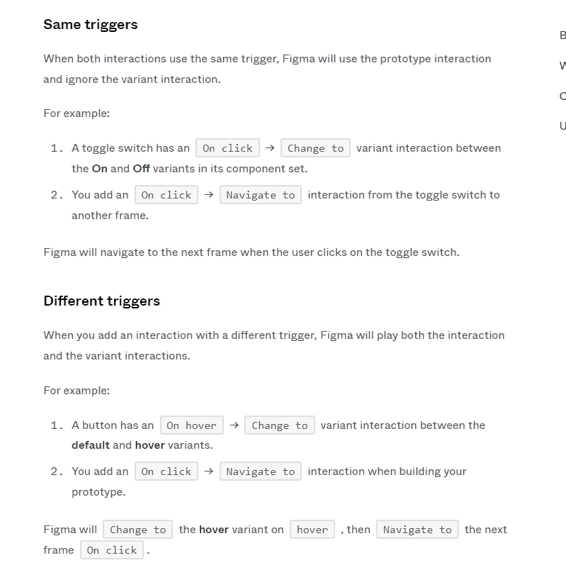

Hi! I had the same problem. It happens because you use the same triggers both for button touch and for scroll.
Here is the link to article - link
