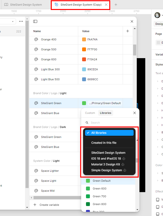

I'm currently working with a published design system library in Figma (SiteGiant Design System).

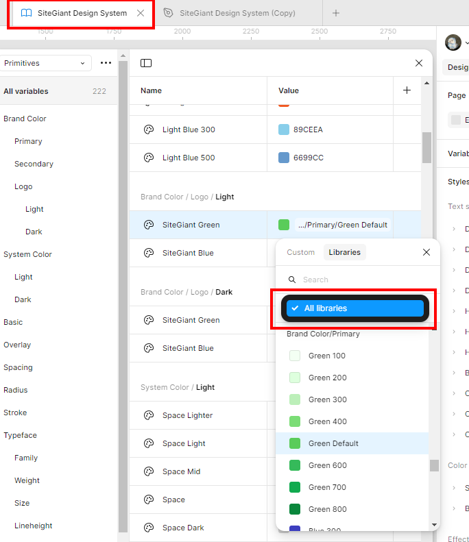

I noticed an issue where the library dropdown in the variable panel only shows “All Libraries” without listing specific libraries (refer to the first attached screenshot).
However, when I duplicate the same library (SiteGiant Design System Copy), the dropdown correctly shows all libraries, including the newly duplicated library (refer to the second attached screenshot).

Problem:
  • I want to resolve the dropdown issue in the original library without needing to re-link all components and variables to the new duplicated library. Re-linking would be time-consuming and error-prone.

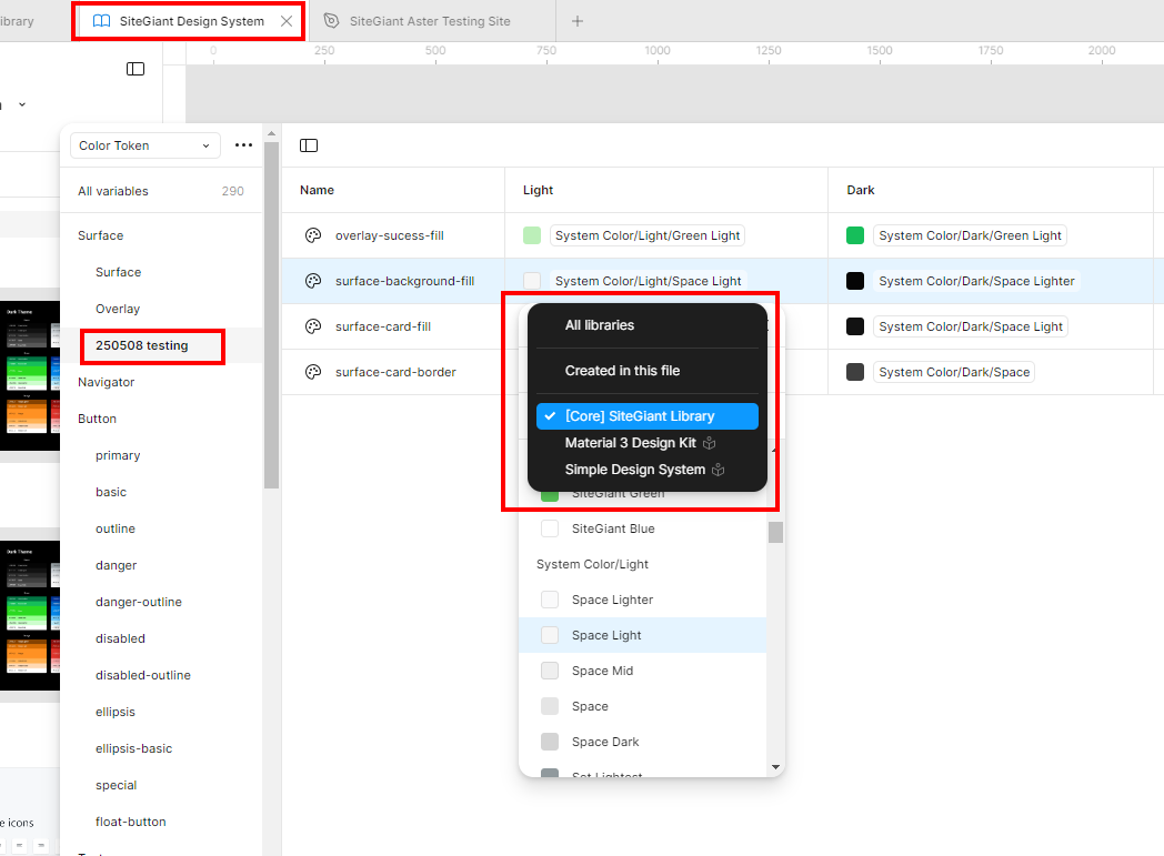

[Update on Variable Dropdown Issue - Resolved]
Hi,
I wanted to share an update regarding the variable dropdown issue I previously mentioned. After some testing, it appears to be resolved now.
Here’s what I did:
  1. I copied the variable linked to another library from another file into the  (SiteGiant Design System).
  2. At first, only the variables copied from other libraries appeared correctly in the dropdown.
  3. About 10 minutes later, all the variable dropdowns started displaying properly.
  4. I also relaunched the app, and it now functions fine in both the desktop app and browser.
Not sure if this is the intended behavior or just a temporary glitch, but it’s working for me now.
Thanks to everyone who took a look at this. Feel free to share if you encounter similar issues or have additional insights. ✨
Hi,
Here’s what I did:
