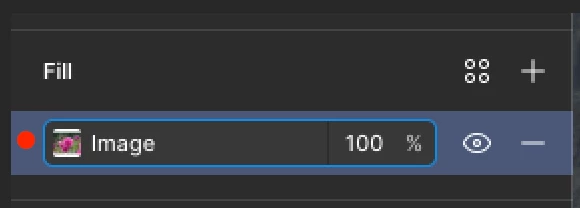

Hi, I’ve been struggling with this on and off. But yesterday I found a way!
With an image copied on your clipboard. Locate your image fill, in it’s figma frame, but don’t click the image fill:
Then click just to the left of the grey lozenge around the fill image preview:
My cursor clicked where the red dot is.
This selects the fill, now CTRL V or CMD V and the image from your clipboard is added as a fill.
It’s quite tricky to click this small area, but it’s got me where I want, I think figma could improve this.
