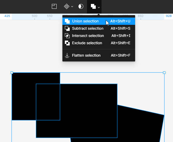

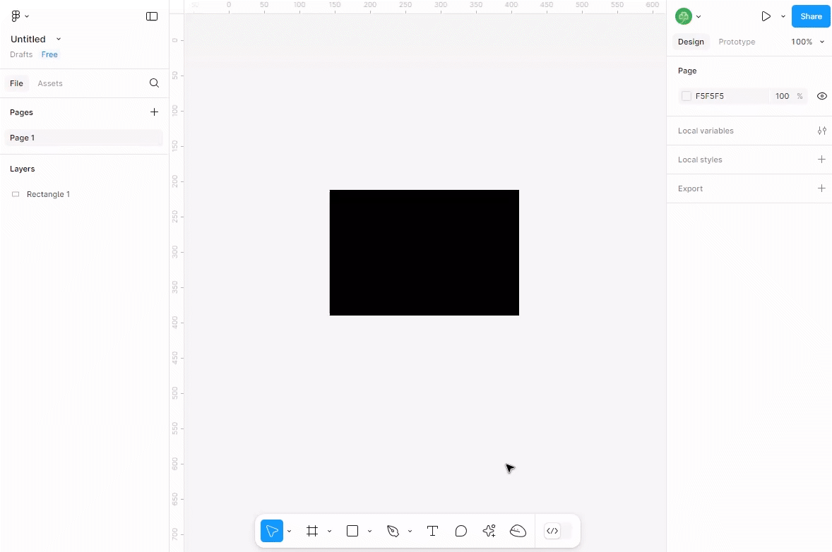

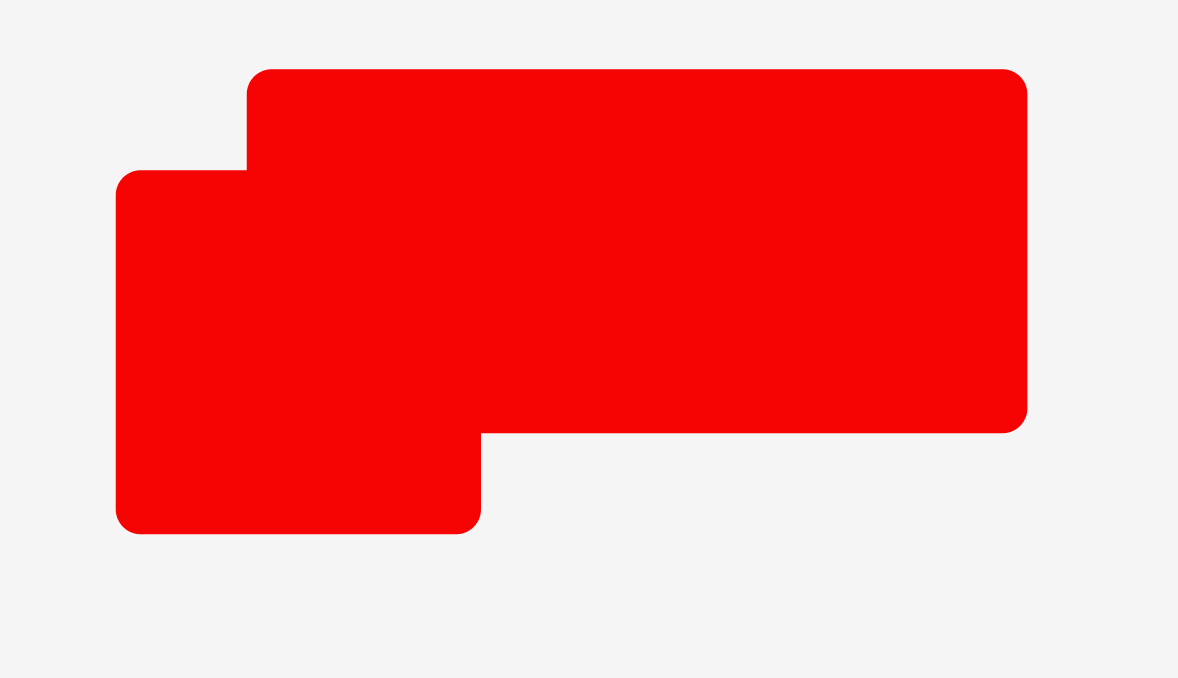

Hi. You can use Union for that. Here is example

Oh my god the second square you put with the rounded is what I wanted I think, I want the same shape to be able to have the same rounded corner. Can I then change the corner radius as I want?
Yes, you can do it anytime
I am trying to have rounded corners here, like you did as well
Make sure you put them in Union. I showed it in the video — just select your rectangles and choose Union Selection in the right panel.

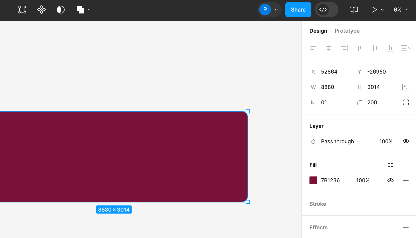

Yes I looked at your video, but I don’t find it in the right panel. How can I see it?

Oh, you use the old interface. In that case, it's here

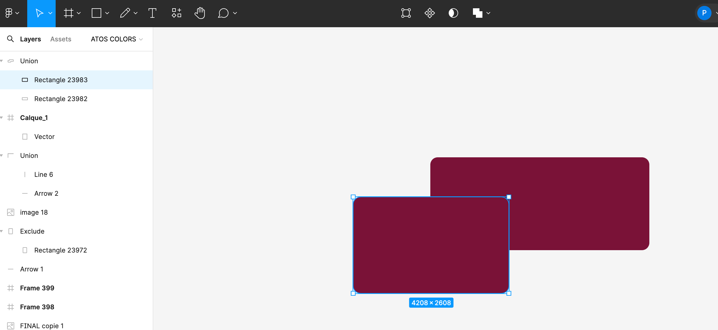

I don’t manage to have the rounded corners ‘outisde’ like you did…. I want to do that
Don’t want a 90° angle.
On the left, it’s considered a Union now. Could you help please? I’d be supeeer helpful

Select Union layer group and change the corner radius from 0 to any you want
