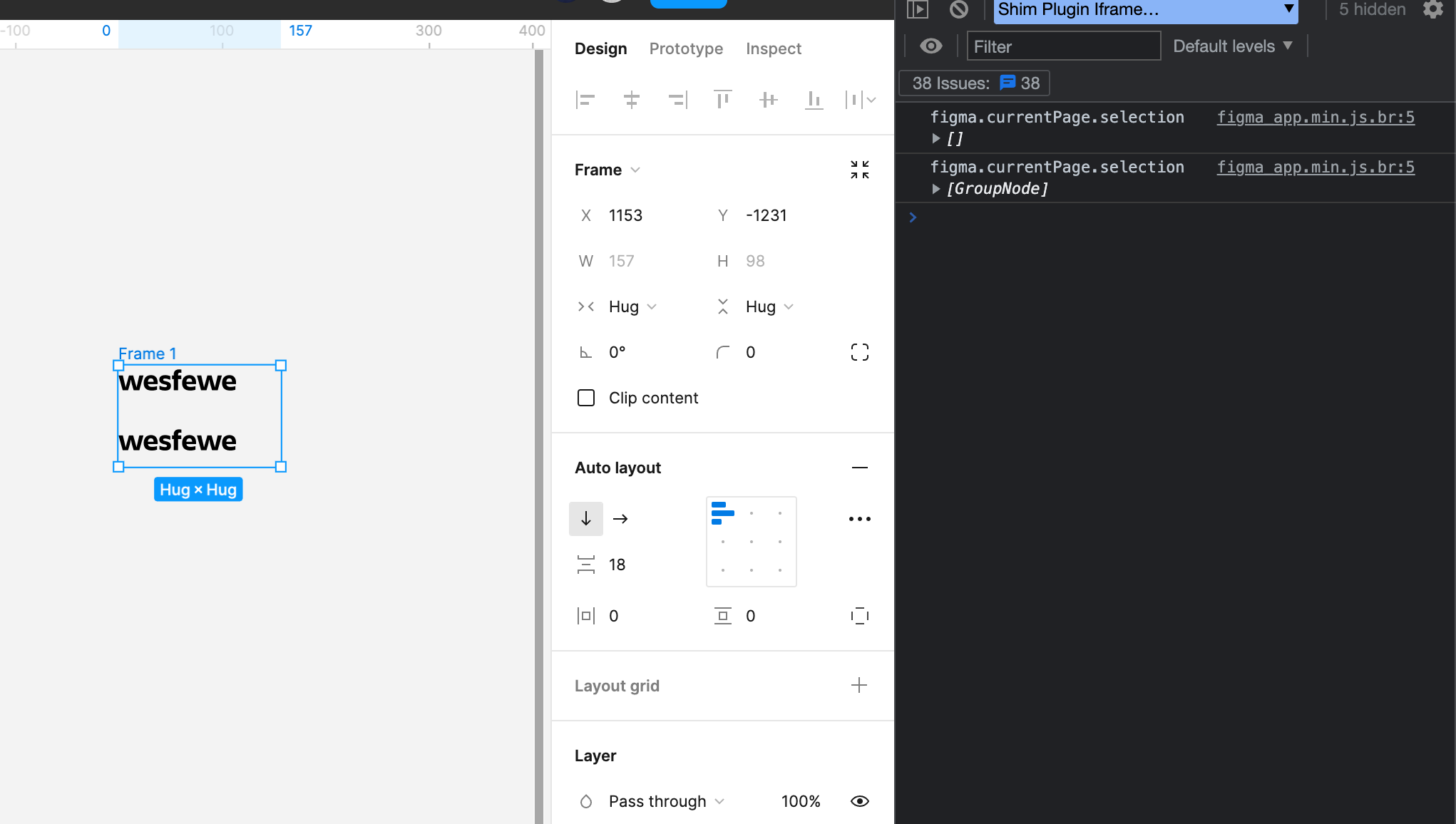

Hey there! I am making a plugin that’s listening to selection changes and running functions based on the node type, but when I group two text nodes the node type is a GroupNode, which is right, but then I add auto layout and the group stay a GroupNode. The strange thing is that when I reload my plugin and re-select the group, it now says it’s a FrameNode.
Is there a reason why the node type is not being updated through the function? Am I missing something somewhere? The select change documentation is so sparse that it’s hard to know what can be done, thanks
See below for the function that activates the console.log screenshot

I can guess that Figma somehow caches the node ids within the plugin session. You can check that GroupNode and FrameNode have the same id.

I thought that too but the Figma DOM updates for any other node type apart from GroupNode e.g Rectangle => Frame. I wonder why the update doesn’t happen for a Group => Frame conversion

RectangleNode doesn’t turn into FrameNode. The frame wraps a rectangle, i.e. creates a new node where the rectangle is the child of the frame. You can still check their id.
