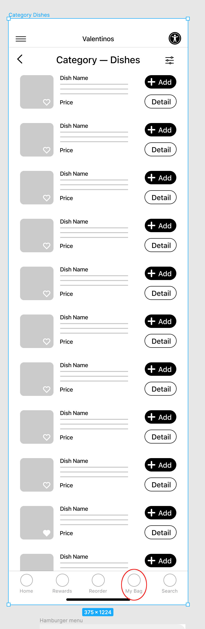

I want to create in a prototype a screen where there are multiple buttons that add an item to a cart. However, I don’t want that the add button takes you to another screen. I want when the add button is clicked it to shows a number of items in the cart icon on the same screen. Kind of like you see in many actual apps. Is it possible to do? Please be detailed as I am new at this.

Yours is just on add button however mine has multiple. So each time the someone add the number in the basket need to go up accordingly. Obviously its possible in the app I guess because of the coding but is that possible also in a prototype or no? Thanks

We had to do a usability test of our lo-fidelity prototype. I got no negative feedback for my design from my peers. However, I got questions, why does the add button take you to the bag page and you have to go back to the other screen if you want to add more. Logically in the actual app which is not a prototype and it’s coded that won’t happen. The add button will add to the bag like I described I want it in the prototype. However, these peers (they are all different levels) don’t all get that some things are actually not possible to do in a prototype.

Can you imagine the amount of work? Your screenshot shows 11 “Add” buttons, which are 2048 unique combinations. That’s how many screens you need to design. Yes, with the help of interactive components, you will only get 12 screens, but for the cart with items, you will need to create 2048 screens, because you do not know in what combination the user will add items to the cart.
How long will it take you to create such a low fidelity prototype?
You need to show an example of one position. That is: if no item has been added to the cart; added to cart. The basket is exactly like this: an empty basket; basket with item(s).
