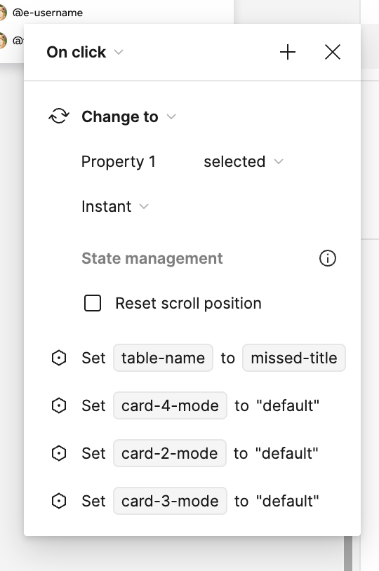

Eve_Weinberg
Please help! i cannot figure out how to copy paste these 4 ‘sert variable’ triggers!!
