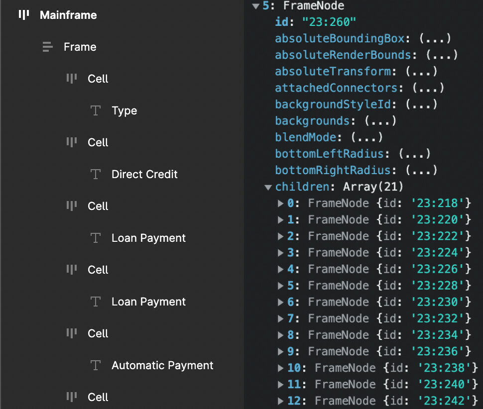

Hi, I am new to Figma API
The Scene tree (screenshot) looks like this, my goal it to select all nodes named Cell
I have tried
  • Double forEach, first iteration returned the Frame nodes alright, but not the Frame’s children…so second iteration only got back an empty array
  • Also tried findAll (node => node.name === "Cell "), nothing returned
However, they are accessible from console window (screenshot). Not sure where i did wrong

Answering my findAll part of the question, turns out I should put
const cell = figma.createFrame();
cell.name = 'Cell';
before await figma.loadFontAsync(text.fontName); otherwise the cell name will still be ‘Frame’. So the search works, I think the forEach also has something to do with Async createText(), still not sure why.
carter1
  • Author
  • New Member
  • 2 replies
  • August 5, 2022
answer my own question again, double forEach works 🤔 I don’t know why it’s not working eariler.
const allSelect = () =>{
    const selection = [];
    const mainFrame = figma.currentPage.findAll((node) => node.name === 'Mainframe-'+ id);
    mainFrame[0].children.forEach ((node) => {
        node.children.forEach((child) => {
            if (child.name = 'Cell') {
                selection.push(child);
    return selection;
