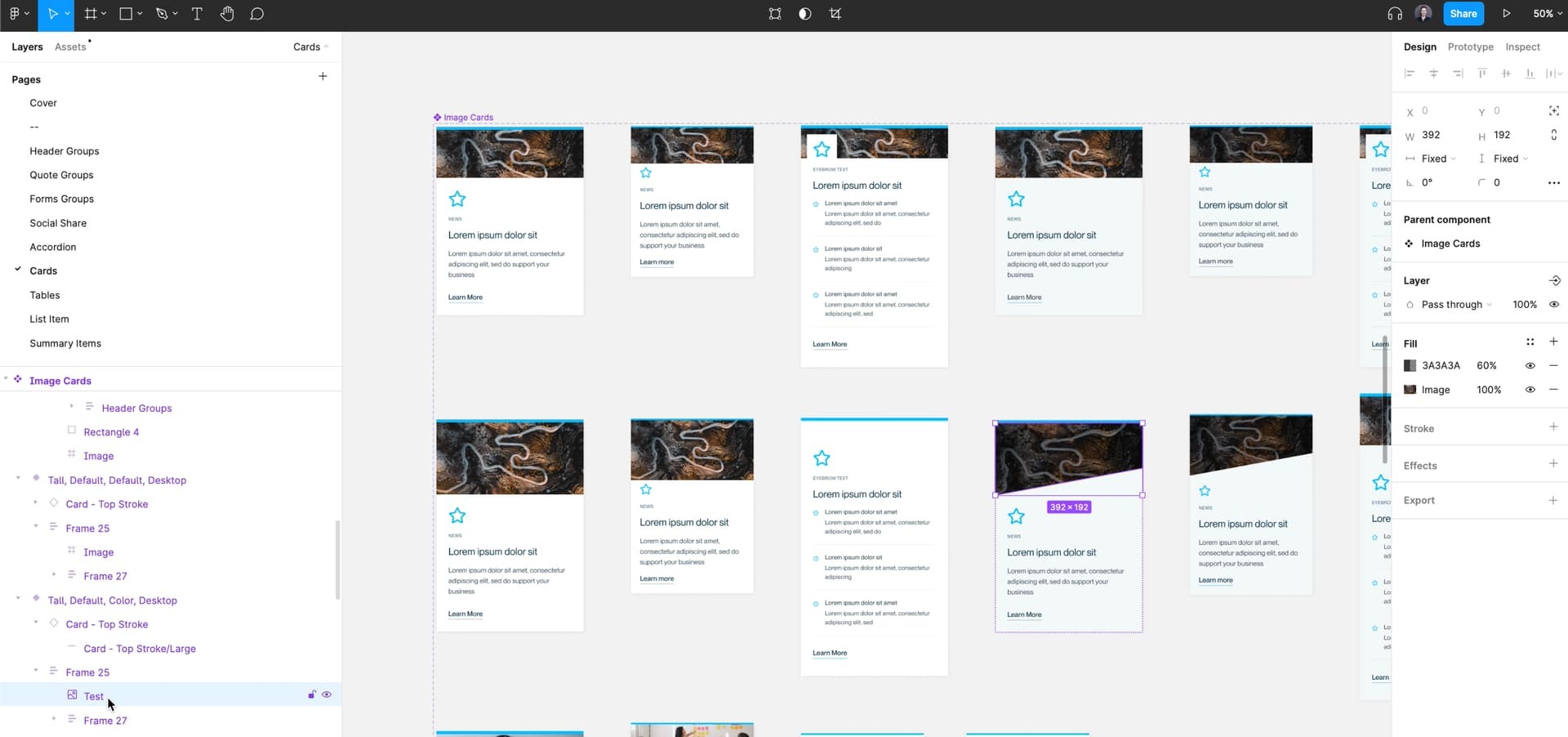

I’m trying to frame an image in a component. When I do that, it moves to another component for no reason. If I click Ctrl + Z, it moves back to the original component and retains the new frame rather than undoing the frame like it’s supposed to. Any ideas on fixing this?

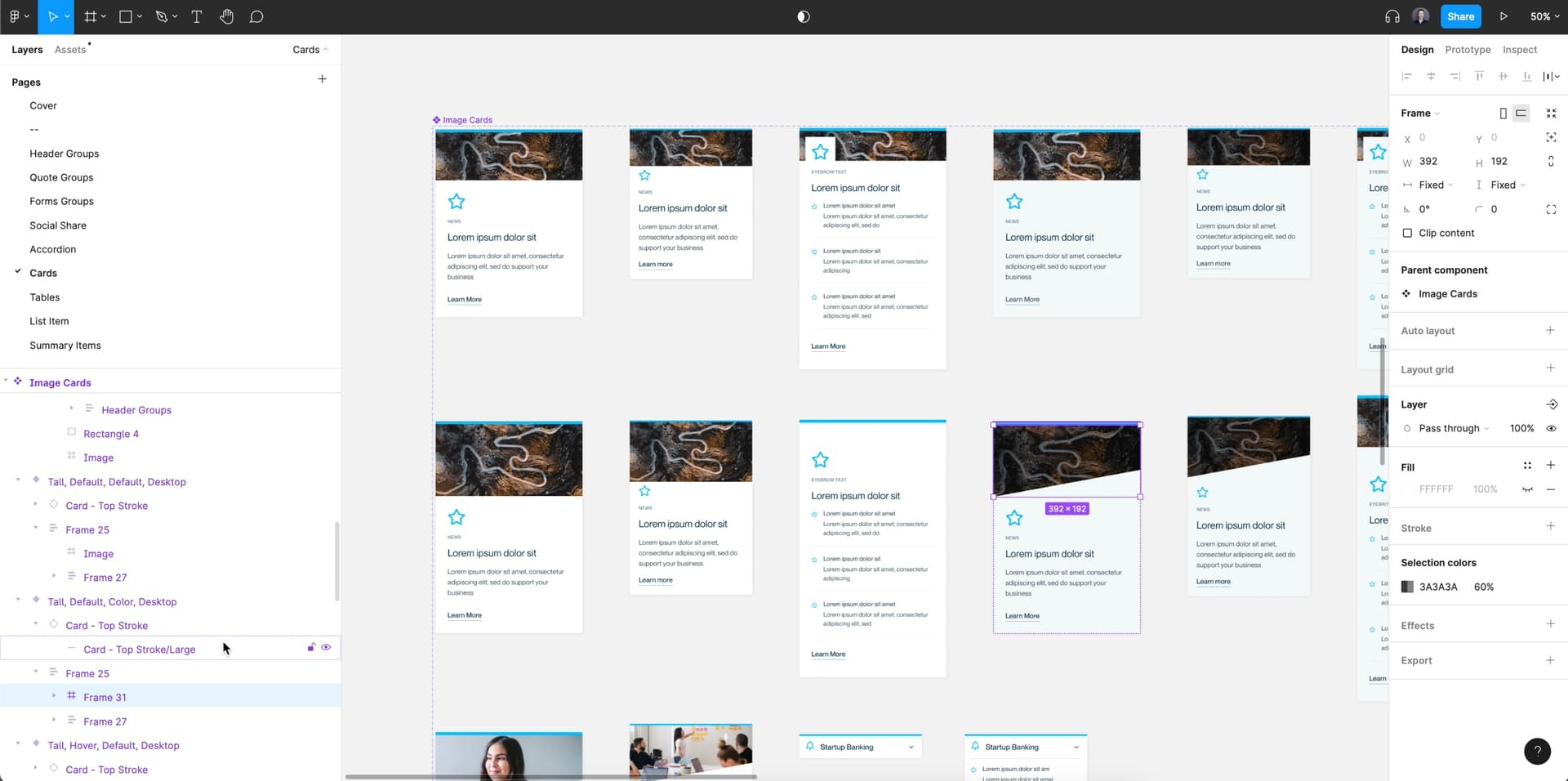

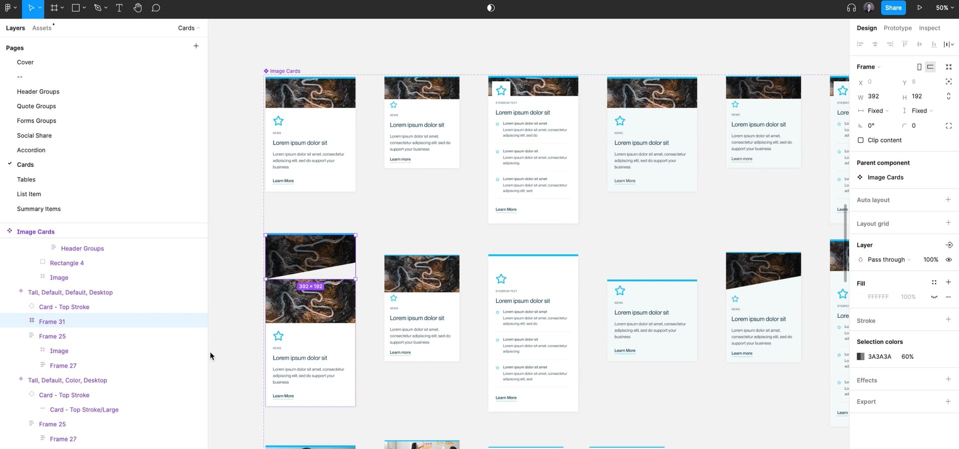

I right-click the layer selected in Screenshot 1, and select “Frame selection”. It then moves to a different component - see Screenshot 2. After I Undo via shortcut, see screenshot 3 - I don’t revert to where I started in Screenshot 1, but it keeps the new Frame “Frame 31” and moves it back to the original component.

hmm, yes now I understand. Looks weird…
it is like something went wrong with the variants at some point. What about if you look at the parent component “Image Cards”, does that look ok to begin with? Are the properties looking ok?
