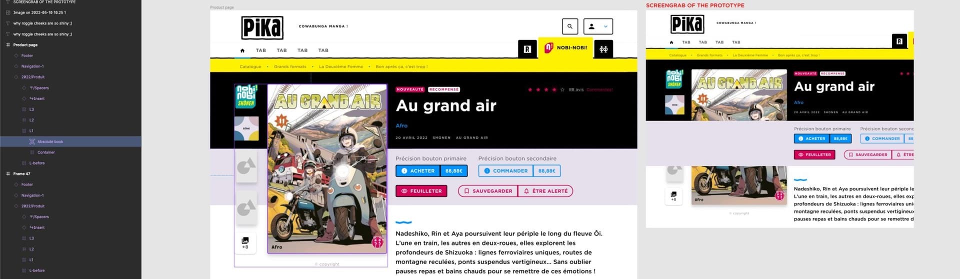

Today they’ve updated figma to 114.6 but there is no change for this bug.
I already sent it to Figma via twitter the day of the release:
"There’s some bugs in prototype with the absolute position
Here you can compare the frame and it’s prototype view
First on top with a frame (book) on absolute position"
Fred_Tinsel
  • Active Member
  • 112 replies
  • May 18, 2022
@Figma_Support I noticed that if I detach the instance where the absolute position is set…
then it renders correctly in the prototype view
