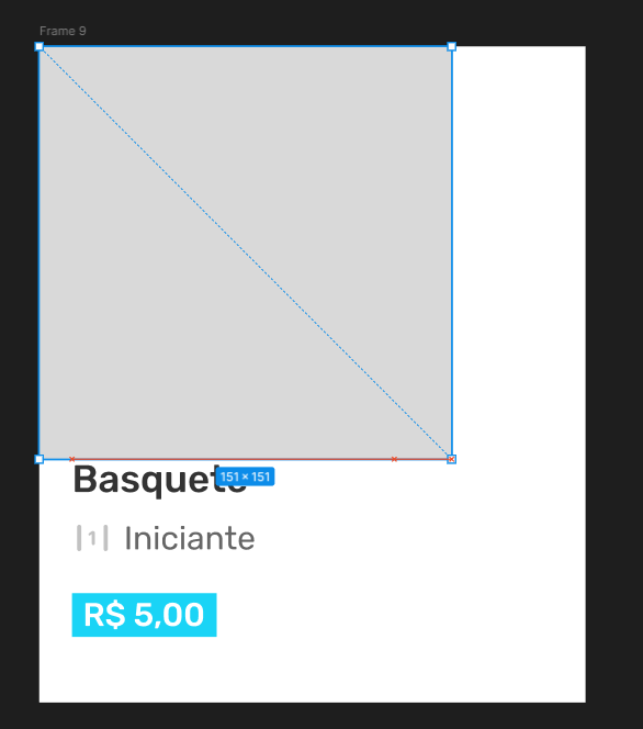

When using the new "Lock Aspect Ratio" feature and adjusting an element’s size using the Ctrl + Arrow shortcut, the resizing behavior is inconsistent and unstable. The size increments/decrements in an unexpected pattern, and the element’s position also shifts unintentionally.
Steps to Reproduce:
  1. Select a rectangle (or any element) in Figma.
  2. Enable the "Lock Aspect Ratio" feature.
  3. Use the Ctrl + Arrow (Left/Right/Up/Down) shortcut to adjust the element's size.
  4. Observe:
    • The size does not increase/decrease smoothly.
    • Initially, the size changes by 0.5px for 5-6 steps.
    • Then, it starts breaking into irregular decimal values (e.g., 0.49px, 0.48px, etc.).
    • The position of the element also changes, shifting towards the direction of the arrow key pressed.
    • If the element is positioned at the edge of an artboard, it moves slightly instead of just resizing.
Original Size
CTRL+Arrow pressed 1 time
​CTRL+Arrow pressed 6 times
It also changes the element position on Frame

Hey ​@yVincent ,
Thank you for flagging this bug! We’ve reported internally and our team was able to reproduce this issue.
Our engineering team is currently investigating. Appreciate your patience in the meantime! 🙏🏼

Hey  ​@Ashley Schoenknecht ,
After checking internally, I confirm our engineering team has fixed both issues ​@yVincent mentioned:
  1. Resize increments were inconsistent: Nudge-resizing now uses clean 1px steps, without erratic decimal values.
  2. Node was shifting during resize inside frames: The ARL node now stays anchored to its top-left corner, so its position remains stable while resizing.
These fixes should make resizing much smoother and more predictable now!
I’ve also checked your post you commented on the other thread, it looks like another issue when swapping your component. I’d recommend you to reach out directly to our support team by filling out this form for further investigation: Submit a bug report
Please use your Figma email account, include your screen recording, a URL of your file and share ‘can edit’ access to support-share@figma.com so our team can investigate it further. Thank you!
