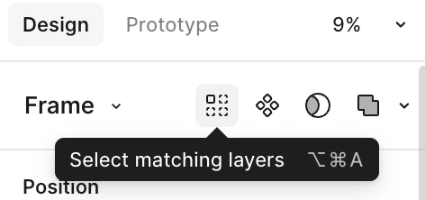

As you pointed out, when you select an object and hold shift, matching objects will be highlighted with a lower opacity border. To select these matching objects, you can click the icon “Select matching layers” in the top right corner (shortcut Mac: ⌥⌘A or Windows: Alt + Ctrl + A).
