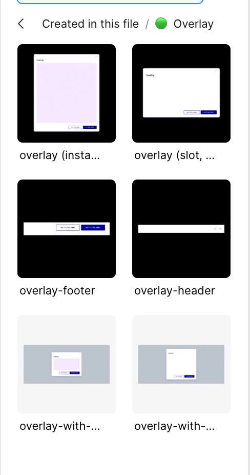

Non-published components don't receive updates
We’re working on a larger Component library that includes non-published components (components with the prefix _ or .) as base components in order to simplify large, complex components. We intended – in some specific cases – to offer regular components as templates, that a designer would then have to detach and work with a bunch of base components to build the desired design.
What we have come to realize with this approach, however, is that these non-published components don’t receive updates from the library when they are updated in the main library.
Is this intended behaviour?
We basically have the option to simply publish these base components as regular components, but that of course would mean cluttering up the assets overview with a bunch of modular components.
