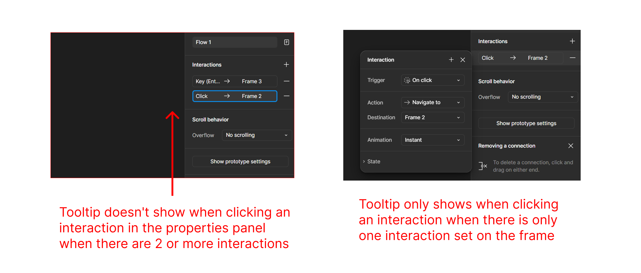

The interaction tooltip is failing to show up in the prototype panel when clicking on an interaction. The issue is happening consistently for me when there have two or more interactions on a frame. When there is only one interaction on the frame, the properties panel does correctly show the interaction tooltip.

Hi ​@mebadea,
Thanks for flagging this! I understand that in the Prototype tab on the right sidebar, when you have more than two interactions in the "Interaction" section, the Interaction details modal doesn't open when you click on one.
And yes, I see this behavior on my end too! I get how much more useful it would be if you could just click an interaction in the Prototype tab to easily see all its details.
I'll check internally to see if a similar report for this already exists. If so, I'll add your experience to it for more visibility. If not, I'll create a new report to pass your insights directly to our team.
In the meantime, I know it's not ideal, but you can still view the Interaction details modal by selecting a connection directly on the canvas. - Connect your prototype

Hi there,
Our engineers released a fix for this issue. The Interaction details modal in the Prototype tab seems to be loading fine for me now.
Could you give Figma a full refresh and see if the panel loads for you too?
