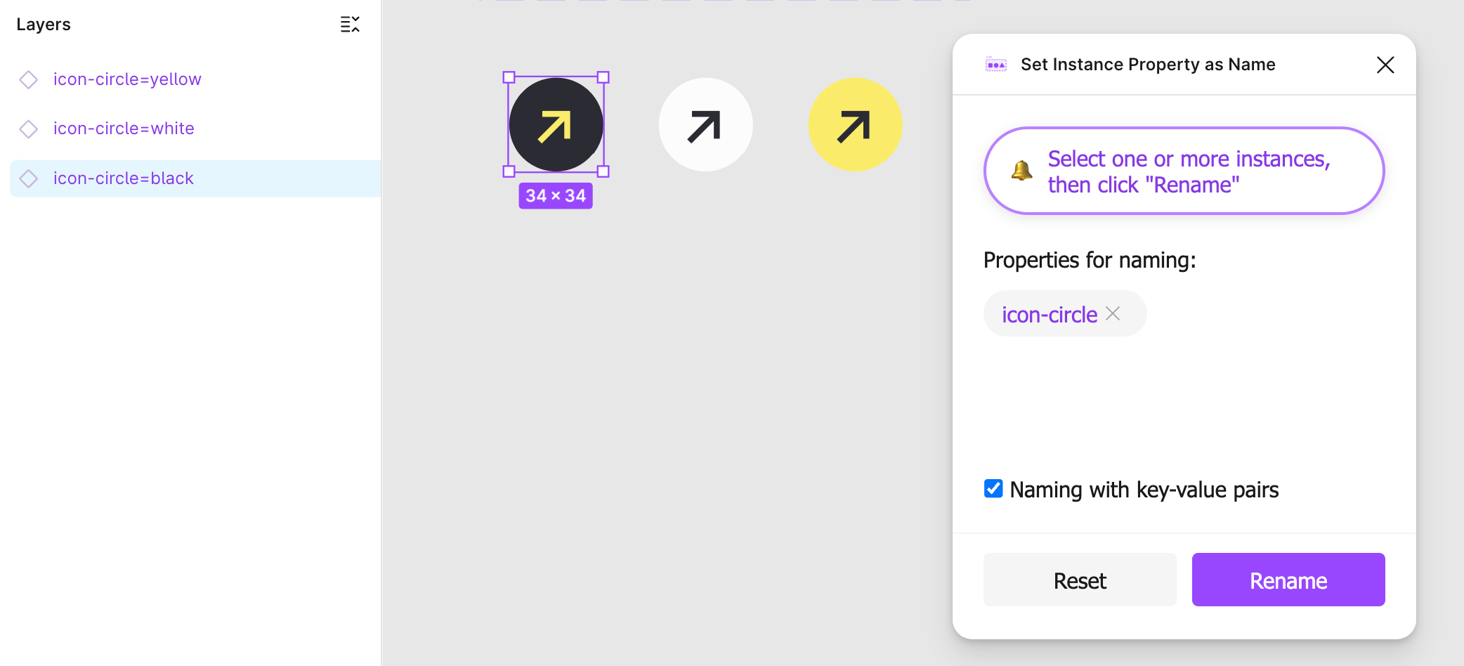

More of a workaround:
  1. move the variants outside from the main component.
  2. now you will have multiple components named something like main_component_name/variant_name.
  3. use Rename it plugin and choose 2.Find and Replace selected Layers.
  4. to Find add “man_component_name/”, leave Replace empty and click Rename
  5. now all components will have the clear name.
  • For multiple variant values you might need to do 4. multiple times to clean other //
