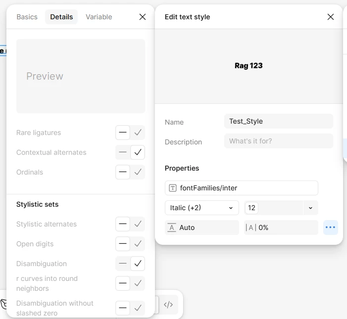

​@angyixin Thanks! Sadly this overwrites all set OpenType Features like monospaced numbers or character variants...
Thanks for letting me know. I added a fix in the latest version, try and let me know if it solved it for you. It preserves all font settings including OpenType features except when you change the font.

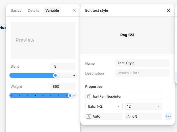

​@angyixin Wow - thanks for the insanely quick fix! Sadly the plugin did not handle weight 650 quite well. Instead it set it to 400 and removed the slant I gave the font. Before it displayed it wrong too.
Is there any option to mass create Styles with this plugin too? If I create styles with other plugins, they all reset the open type features… :/

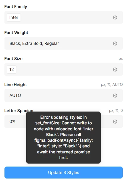

​@angyixin Furthermore I got this error, trying to update multiple fonts that contained weights like 850 etc. (just use a variable font like Inter or Material Symbols (both by Google Fonts) to try it).
