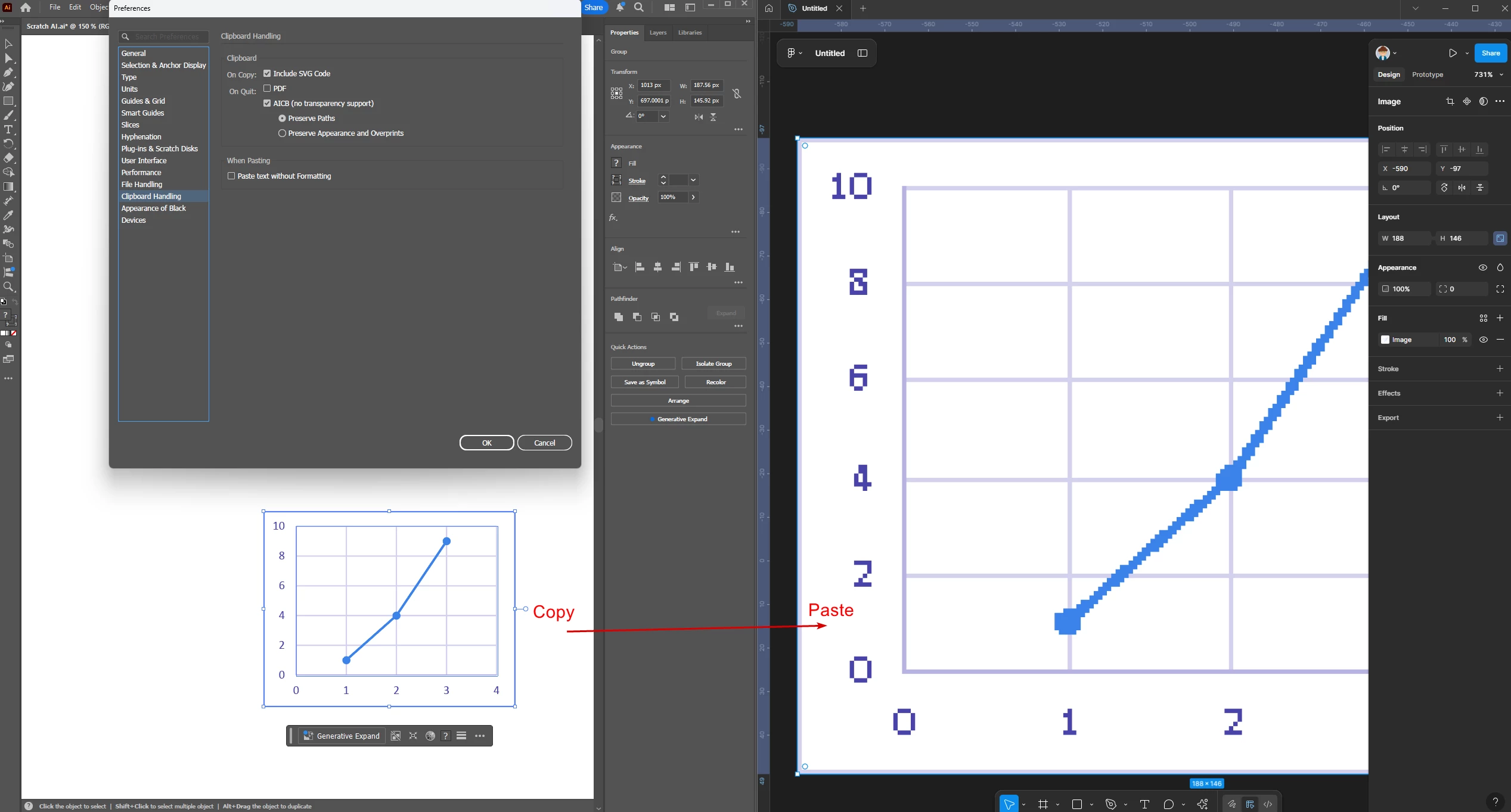

I’m hoping someone can clarify this for me. I used to copy objects from Adobe Illustrator with Cmd +C and paste them into Figma with Cmd +V, and they would arrive as editable vectors. I’m absolutely certain this worked before.
Lately, though, every paste comes in as a flattened image instead of vectors. Nothing in my workflow has changed, so I’m starting to wonder if I’m losing my mind!

Hey All, thank you for your patience while our team worked towards a solution with Adobe!
Adobe identified the root cause and now have a fix in place. The issue stems from a code change introduced in version 29.8.x and is not related to the recent SVG settings change. They also confirmed the exact repro: the issue occurs when the SVG “Minify” option is enabled.
They will be disabling the feature flag associated with this code change and will let us know once it’s complete. After the flag is turned off, you will need to restart the application and Copy/Paste with the Include SVG setting enabled to ensure it will work as expected.
You can find the setting under File > Export for Screens, and hit the little settings icon in that Dialog...go down to SVG and uncheck minify (until the fix has been fully rolled out by Adobe).

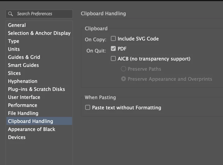

I solved with  Preferences > Clipboard Handling> check Include SVG Code

Hey everyone, thanks for flagging this! This change is due to the recent Illustrator update (version 29.7.1). Head into Illustrator’s general settings and make sure “Include SVG code” is checked under Clipboard Handling. Once that’s enabled, vectors should paste as vectors again.
Let me know if you this is not working for you, happy to help further!

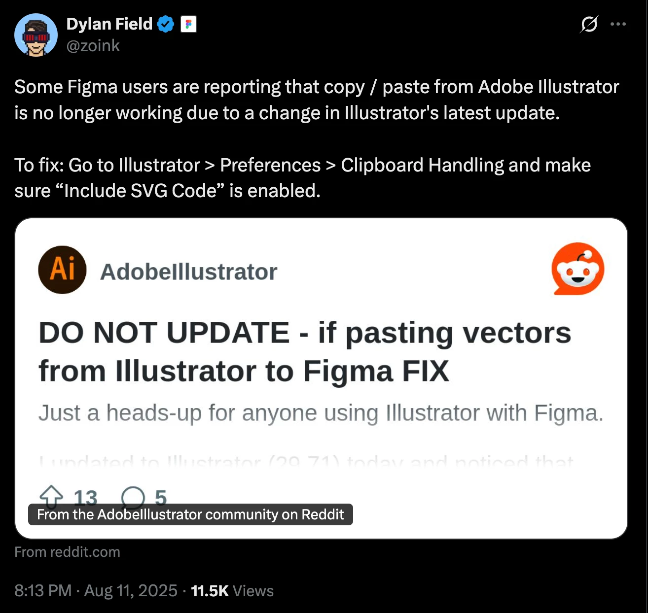

Hey all - first, sorry for the disruption this may have caused you. We worked diligently to make sure this got addressed asap, and Dylan posted some info here (if you haven’t already seen it): https://x.com/zoink/status/1955105303931843008
I hope this is helpful for you -- let me know if you continue to have issues.
