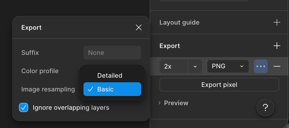

​@Salavat Abdullin ​@Robert Grund ​@begreen ​@Eunmac ​@pcote I’m curious if our export settings are meeting your needs here? Under the more menu, you can switch from Detailed to Basic. In my experience, it seems to be what y’all are looking for.

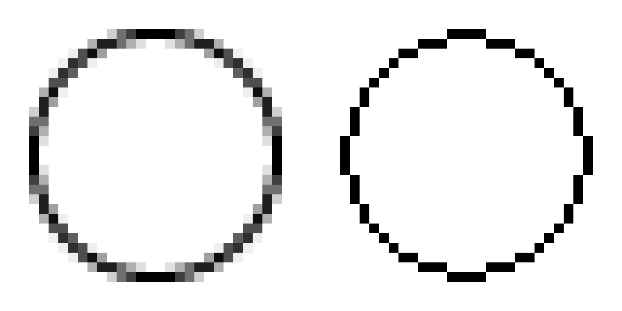

@Rogie_King Thanks for the reply! I wasn't aware of that function, so I tested it straight away — unfortunately it doesn't seem to work for me. I'm still getting anti-aliasing with these settings (see left). What I'm after is that hard pixel effect with font hinting. The preview on the right was forced in Photoshop (indexed color), but it doesn't accurately represent actual e-ink — some of the finer details in the fonts get lost.

​@Rogie_King Thank you for the reply, but “anti-aliasing” is not the same as “bicubic resampling”. Here you can see the comparison. What we need is an option to deactivate anti-aliasing.

  • After that: Basic resampling on PNG export. Detailed is the default and it silently blends pixel edges on the way out. Switching to Basic made a visible difference for me on any frame with actual pixel work.
