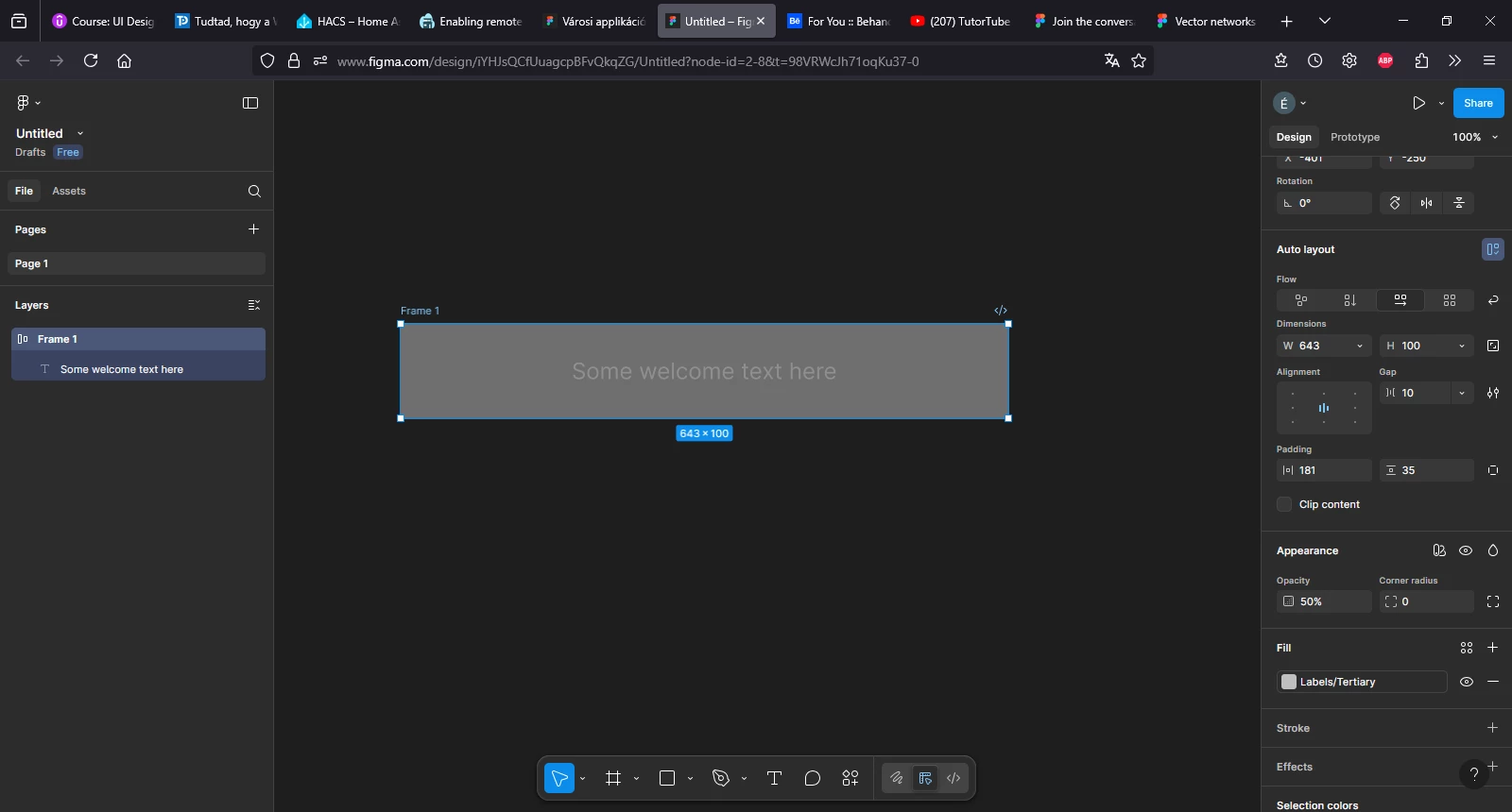

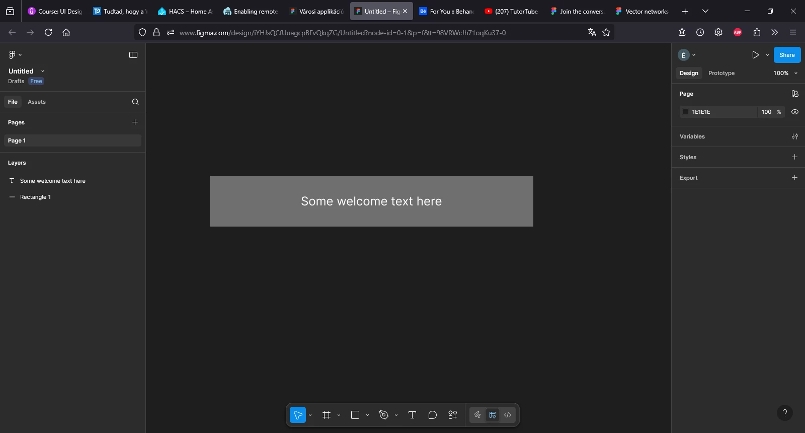

Hello Everyone,
i’m a beginner Figma user and want to design a banner for a home page. My issue is the following: rectangle and text created and then autolayout for the whole group but when i want to set the opacity of the rectangle (50%) the text color is also become lighter. See the pictures attached. Does anyone have a solution for me?Thank you in advance

There is no rectangle on your second screenshot — only the frame and the text within it. You adjusted the opacity of the frame, which is why the text inside became transparent as well. The solution is to change opacity of the Fill, but not the Appearance. But to do this you need to detach the color variable.
