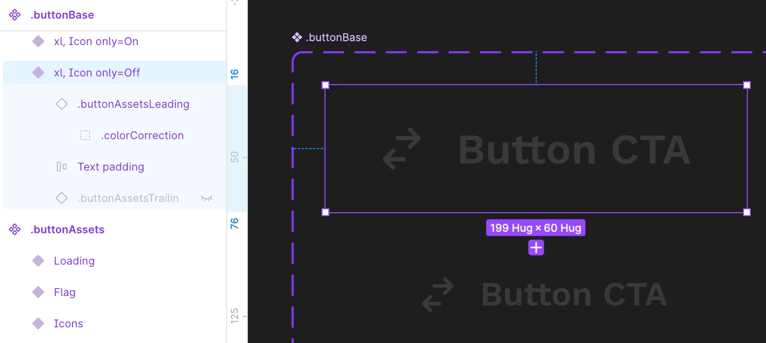

hey! I know it's been a while since you posted this but recently I've come across the same issue and would like to share the workaround I found for it after 2 days of smashing my head against the wall :)
Apparently this problem occurs because of figma's confusing and honestly lacking "maintain override" rules. As in: your icon placeholder (camera) will ~almost~ always work since its color style is ""documented"" on your Main Button Component, but once you change the instance (eg. arrow) and the button's size and type/state… well, figma kind of gets lost cause even if your icons share the same structure they're not the same component, so in a way you never overrode your arrow color. (anyway that's my take as to what may cause this issue)

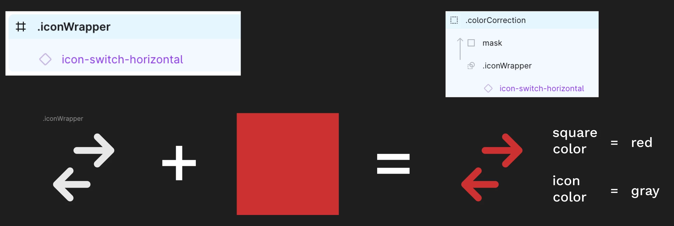

Ok but how do we work with what we got? Masks! Once you take your icon placeholder, mask it and put inside your button component the color you set will never be applied to the icon itself but to your mask. This way you'll be swapping the icon but it's fine since the color override will happen on a… let's say "always present and constant" layer that's already been "color mapped" on your main button component. And it worked for me like every. single. time!
Here's a step by step so you can try it for yourself :)
  1. create your mask group
    (You can opt to turn this group into a component, personally I don't like this approach since your "swap instance" will have to be activated inside this "mask component" and you'll lose the flexibility to set different preferred values for each specific use)
  1. place this masked group inside your button primitives and select the nested icon to create the swap property

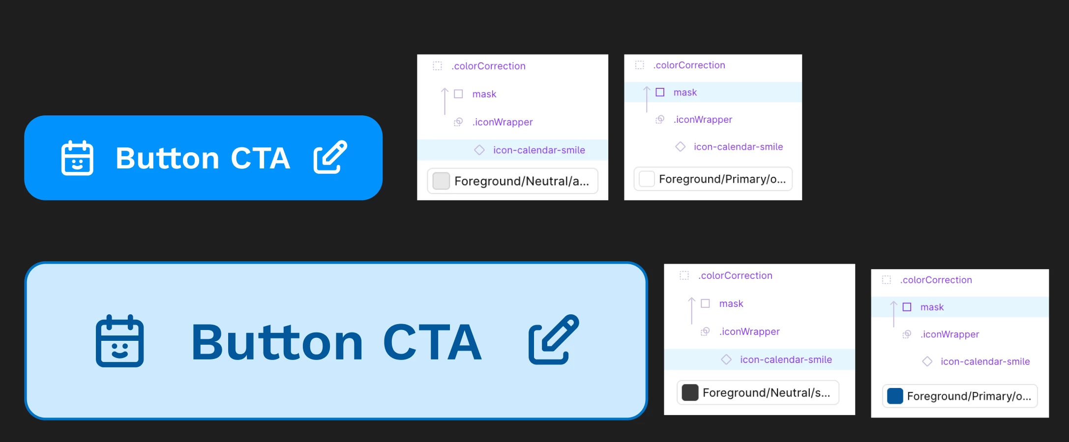

    3. And that's it basically! Just remember to expose the nested instances when working on your main button component. Now when you set the icon color for your primary button it will actually be applied to your square/mask, so basically what we're doing is creating a manual color override!
    You can see that I changed size, icons, style and states and the colors that I defined on my main component are still matching. But if I select the icon layer you'll see that the "automatic" color override failed: small button is using the color I set on my button primitives, large button is using my default icon color (straight from my icon library). And ✨ it does not matter ✨ all thanks to our mask!
