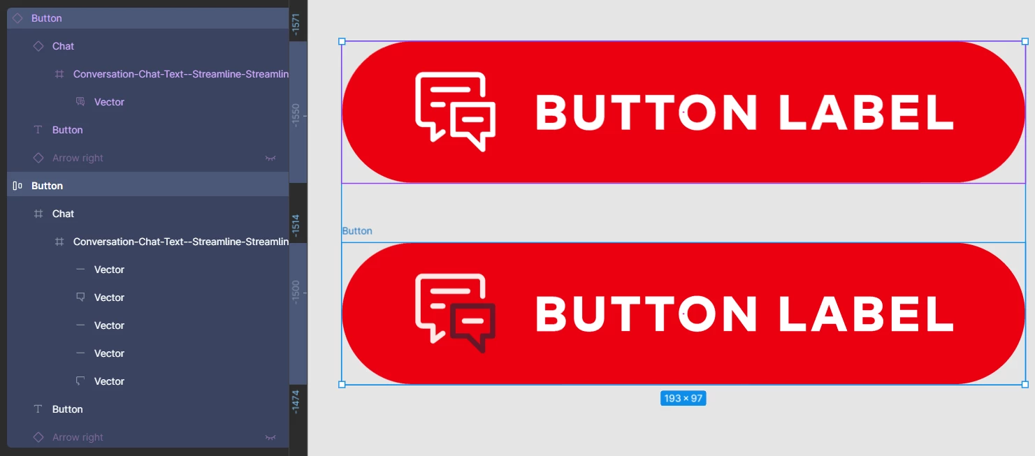

Our icon library consist of only stroked icons. To counteract that the icons can be mutiple colors upon color change, we’ve decided to flatten all of our icons to one vector. This has helped us avoid colors on icon instances break. I’ve tried to visualize below what i mean below
We’ve kept the icons stroked to have more control over the appearance. Cases could be if we add a new size of icon or want to design a new icon based on our pack, then we have the vector paths easily ready for that.
I appreciate your solutions and have now played around with them, but the use of ellipses seems to have the same issue. Using icons with fill is not possible in our case as explained above. This is also why we wish to keep our “icon color variables” scoped to strokes only.
If you have any other questions or need more context I’d happily answer everything I can :)
Gladly let me know if you have any other suggestions. We’ve dappled with the idea of isolating our icons in its own library to solve some of the mentioned issues. Right now it is connected to our design system containing components, patterns & templates as well.
