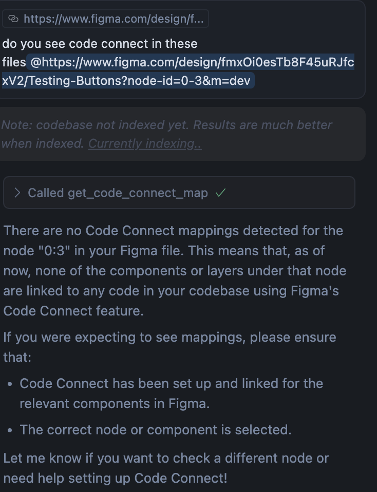

I have code connect snippets set up within my Figma system and I am attempting to use Cursor to get the code from Figma. When I try to do this, I am receiving this response, stating no Code Connect files exist.

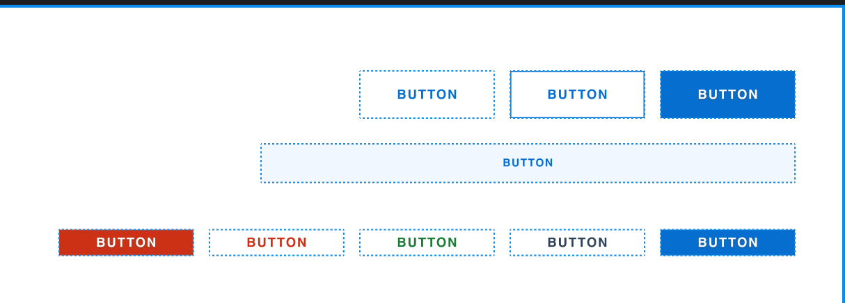

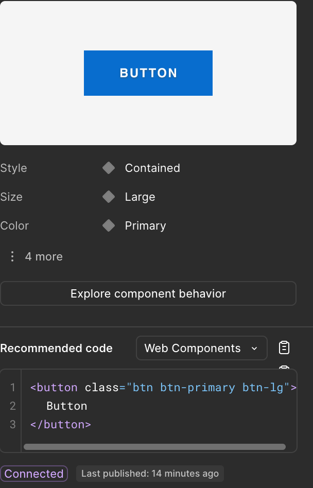

Below is a screen shot of my frame and connected snippets. Did anyone else encounter this problem and have any solutions? This was working for the past two weeks so wondering what has changed with MCP or Cursor.

I have the same problem.
Also code connect is set up in html mode

Just sharing here for visibility, at the moment, this command works only on instances, not on component variants. Apologies for any disruption this may be causing. The team is actively reviewing this and exploring possible solutions going forward.
