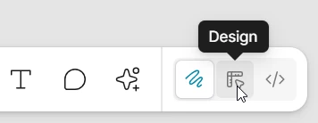

How to add layer icons back to Figma UI?
My Figma app updated and the new layers UI has become unusable for me. I rely heavily on the previous layer icons to know what is a frame vs a group vs autolayout vs a component.
The images in the layers panel is not useful to me. Is there a way to restore the old icons in the layers panel?

    You are probably in Draw mode. Switch to Design

    Thank you! I definitely was...
