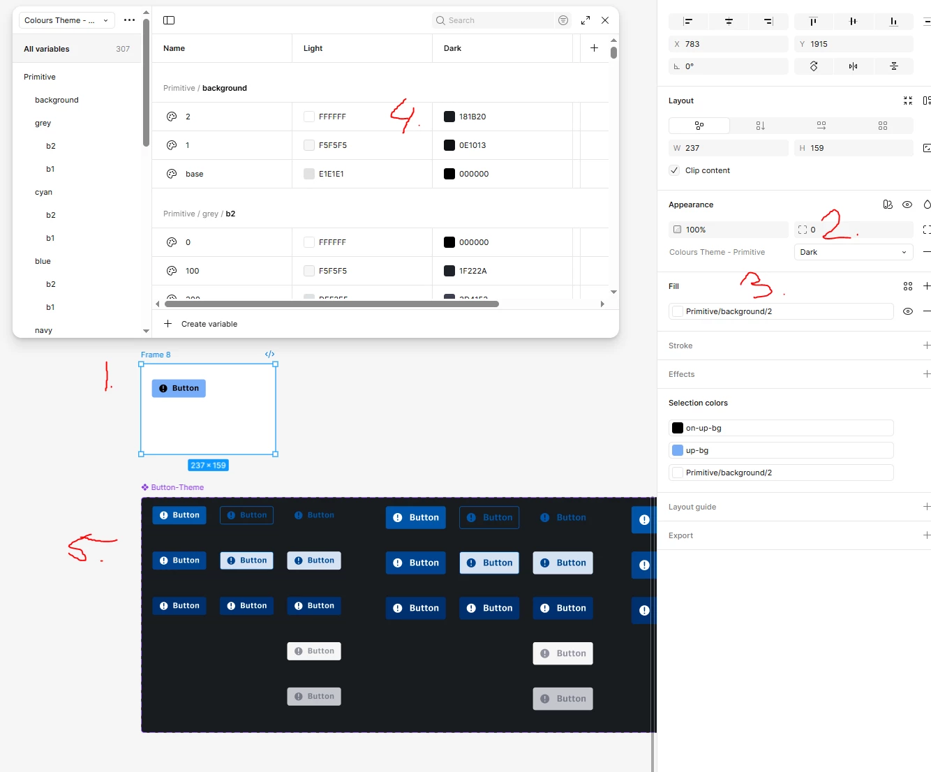

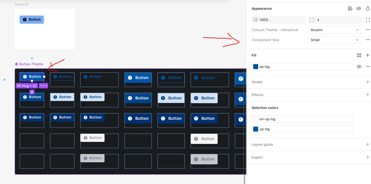

I have been having a similar problem.
We have created modes for “tvOS” and “CD”.
We also created a text string to swap components based on mode and applied it to our button component.
The modes swap components and overrides perfectly when in a standalone frame, but breaks down when the same setup is applied to a component.

Lisa_Morellini
Jun 29, 2024 2:13 PM UTC
I’m also having this issue.
I have a ‘wireframe’ layout for a component, and then a more detailed ‘mockup’ version with text and images within it. The goal is that I can wireframe a layout, and quickly, when needed, swap to a mockup.
Using a boolean variable seems to work for a few components, but then after applying it to a few components and testing, eventually I start getting blank components, making it appear as if it’s just disappeared when I change the mode of a block.
Then, as I scroll around my file, the others I previously swapped fine, start to disappear as well.
It feels to me like it’s an issue with loading/memory usage.
