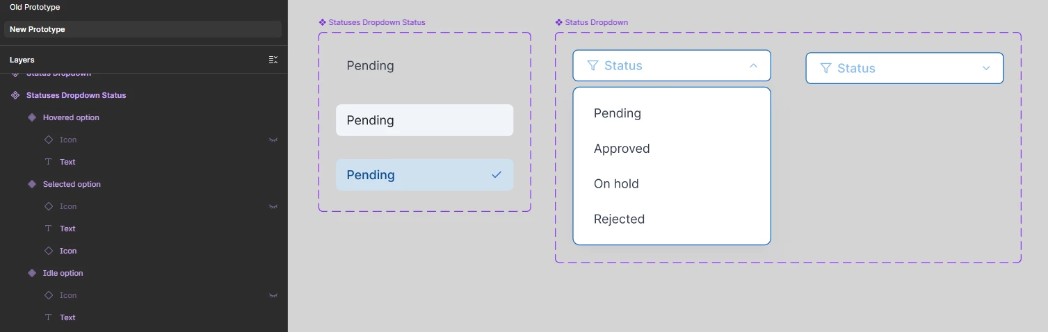

Hi all,
I had the same issue but I managed to solve it.
What worked for me (hopefully will work for you too!) is that I had to rename all the instances to match across variants.
In my case, I had a drop-down menu with 4 different entries. I wanted the entries to change color when hovered or clicked. However, their text would also change to “Pending”, since that’s the text from the component.
As mentioned above, only when all elements where named the same (e.g. all texts are called “text”, all icons are called “icon”), then it worked for me, and hovering on “approved” would change the background color without changing the text inside.
Best of luck with you project!
