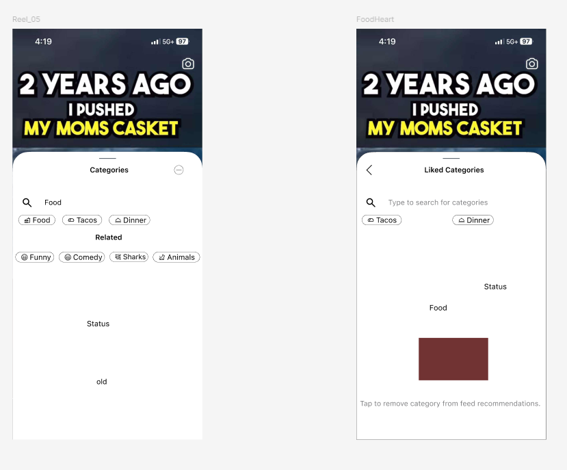

Variables seeming to not properly adjust between Frames
  • June 27, 2025
  • 65 views

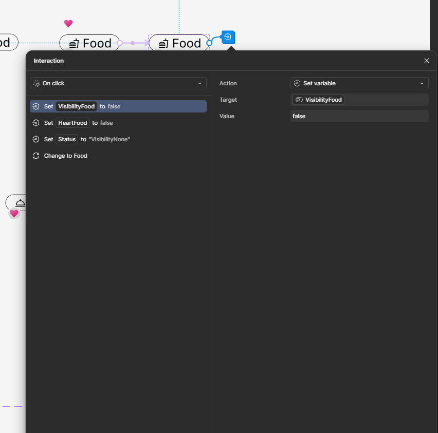

So I am trying to make a “like system”. When going between these two frames the state of the liked “Food” box should remain. I have both visibility and the status of the heart set up as variables. It does remember the state when moving from the first frame into the second, but not the second into the first. Meaning if I change the state in the second one it does not transfer back to the first, the first will stay how it was.  The food category is there on the second frame it is just not visible due to being tied to opacity. When you click it on the second frame it disappears, how I want it.
I can send more images or try to explain better as well what I am trying to do.

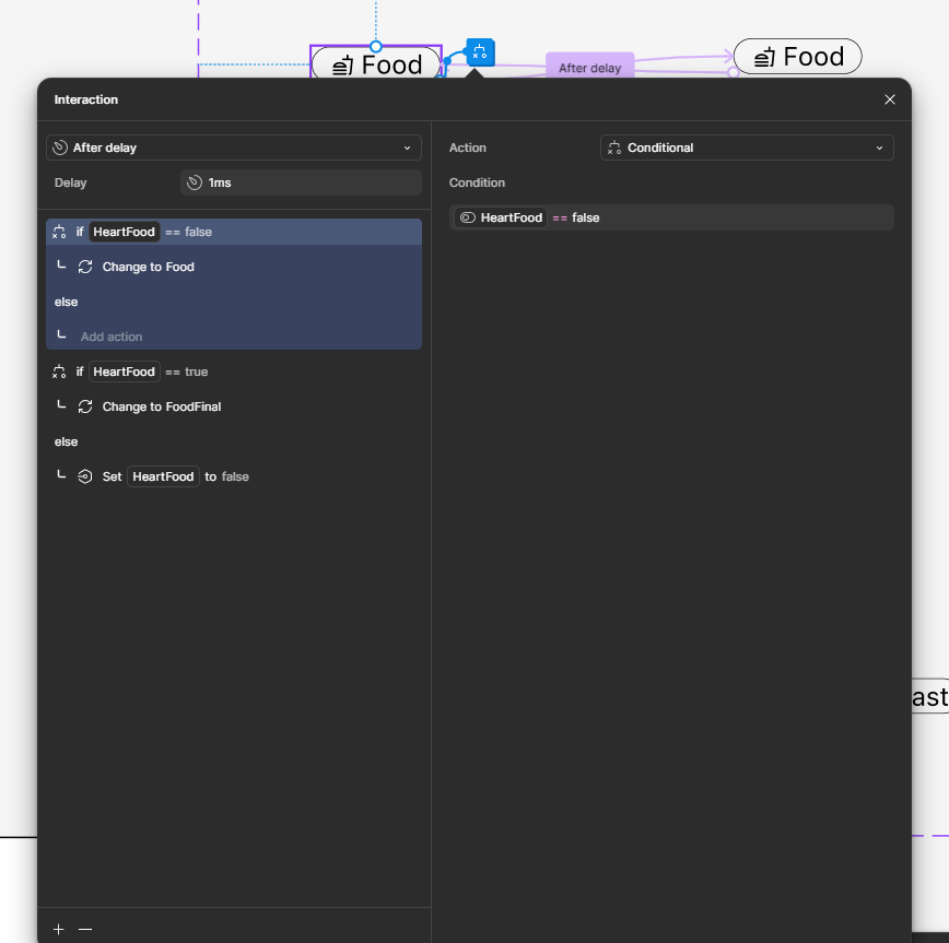

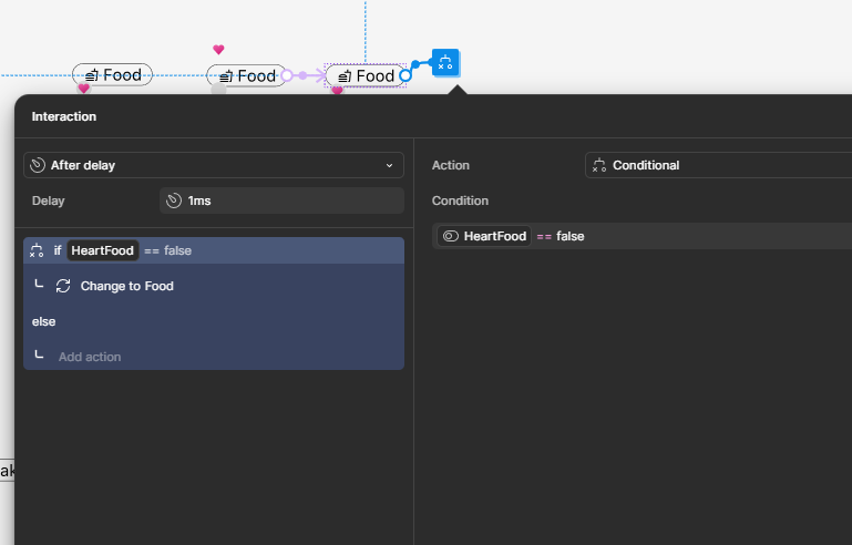

I figured out a really janky work around by checking in the final state if HeartFood == false, change it to the first one. But the thing is that it shouldn’t be going to the final state if that is true anyways.
