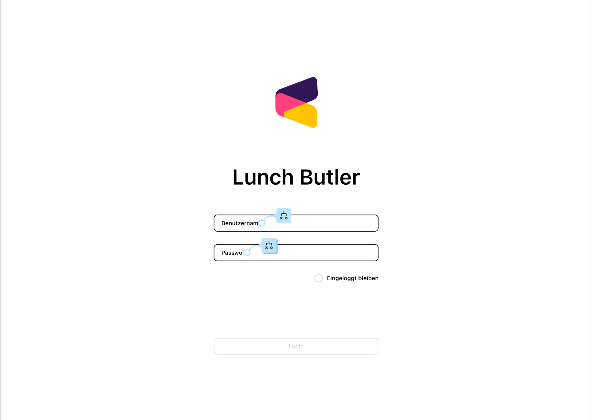

I want to make a Login Screen and when 2 Textfields are prefilled with the correct values, the Login Button state should swtich from inactive to active.
What I already did:

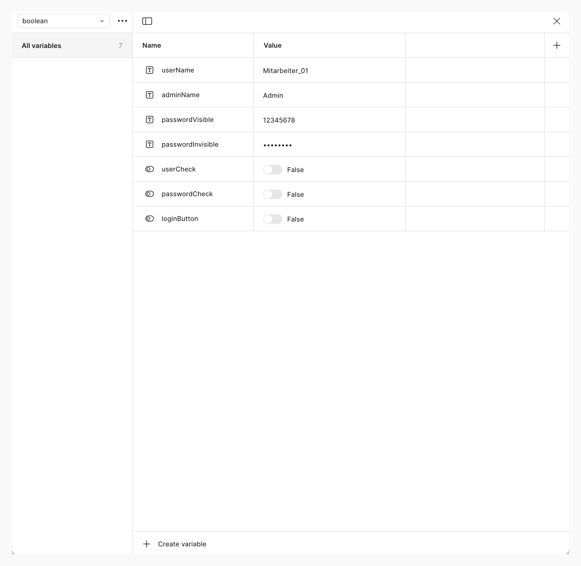

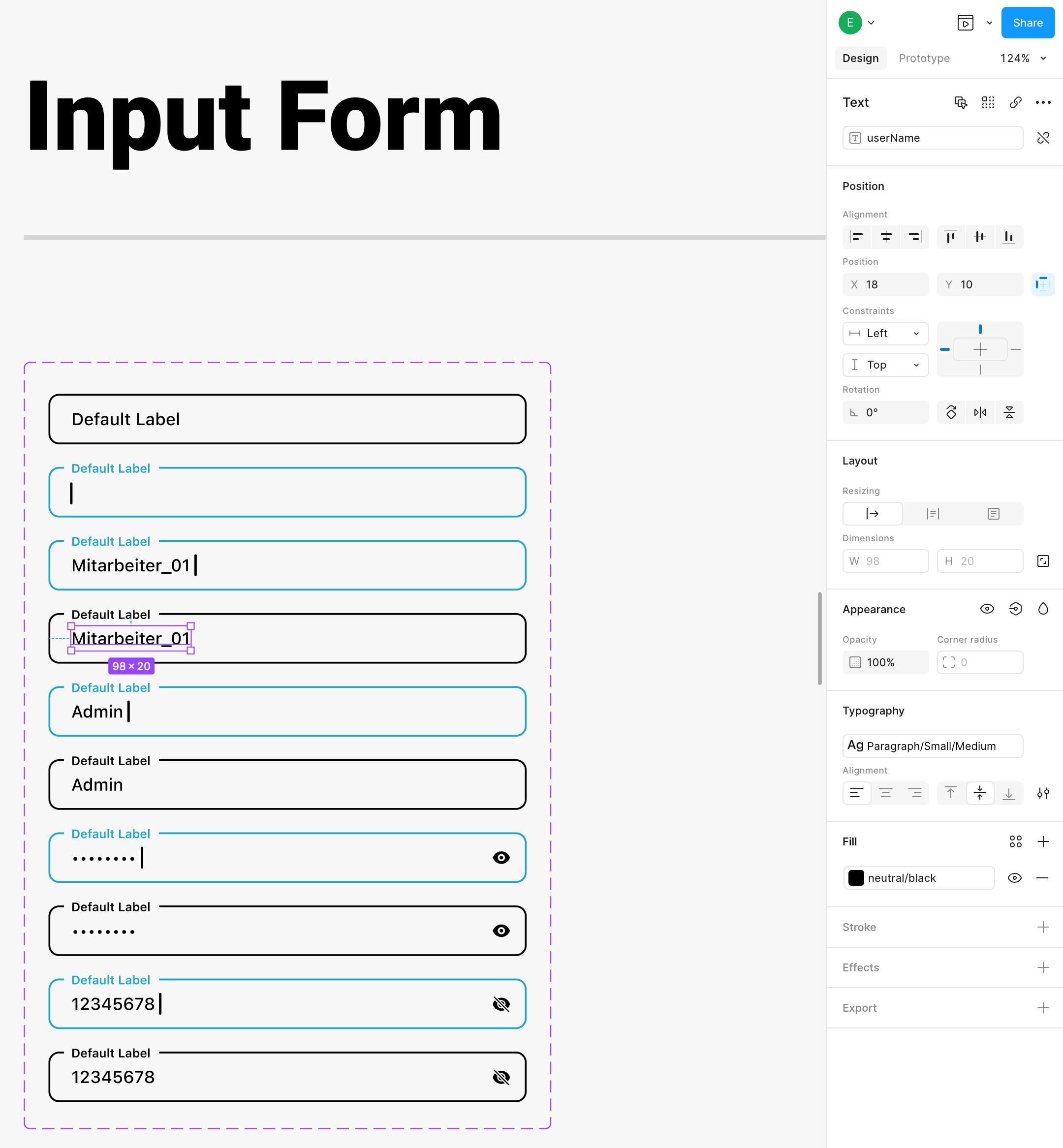

  • Defined the components with the right pre-defined variables
  • Used a boolean for the button state and linked it to the button
  • Tried out manually in the Variants panel - works

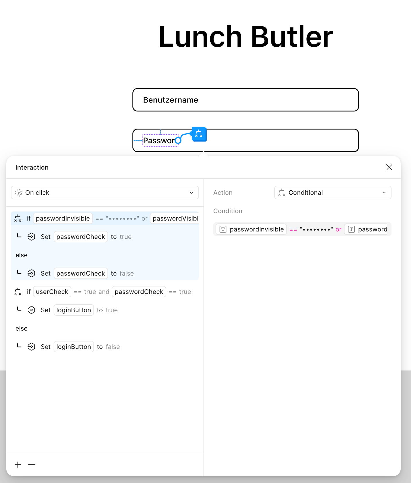

  • Put the button active logic into the password section, so it will be activated as a top down expirience
  • Linked directly the textfield to the pre-defined variables, not the whole Object
The logic I am using is:

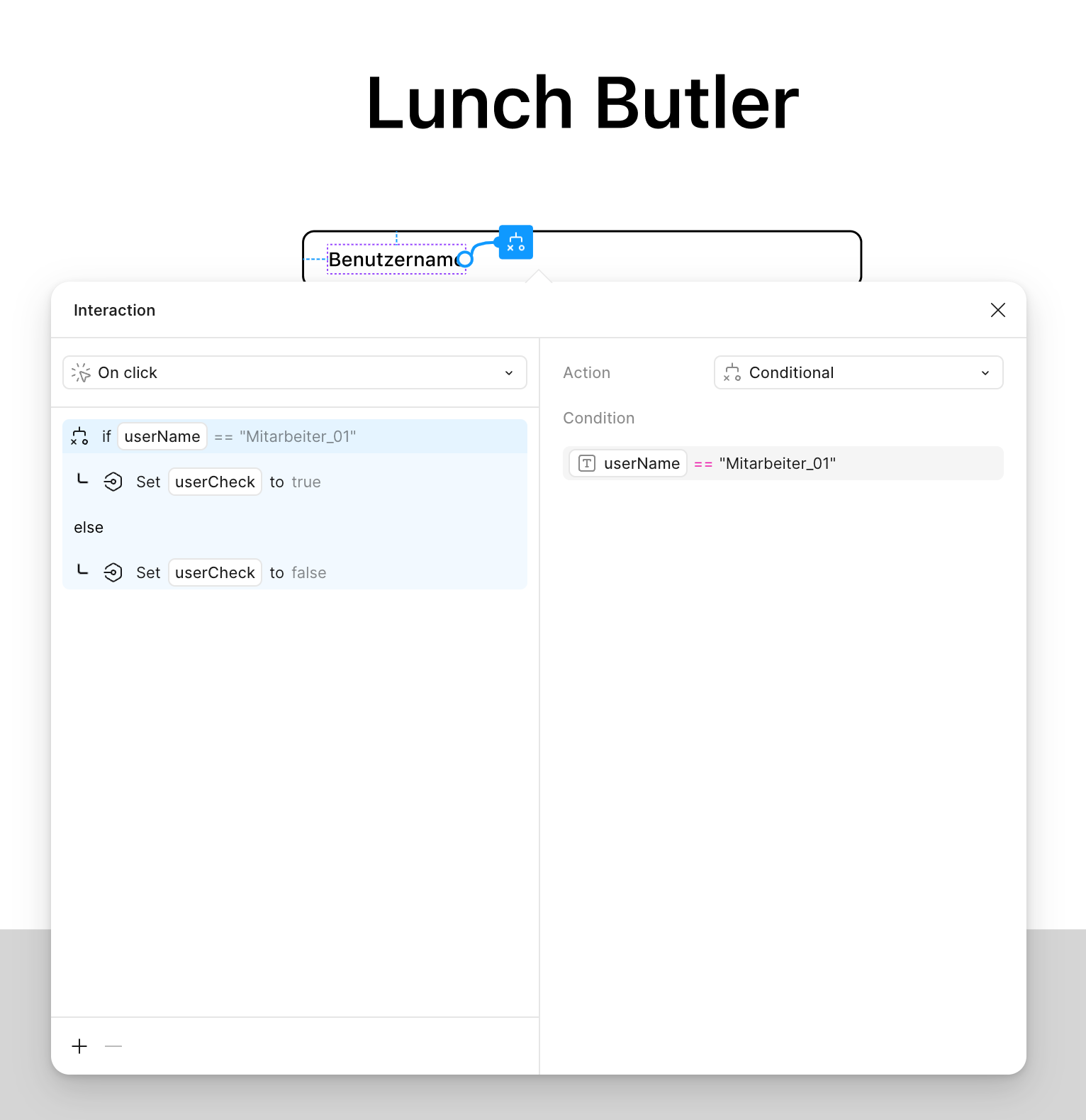

  • When User field is filled correctly, userCheck Boolean becomes True
  • When Password field is filled correctly, passwordCheck Boolean becomes True
  • When userCheck and passwordCheck are True, loginButton should become True
For the rest, see the attachments
