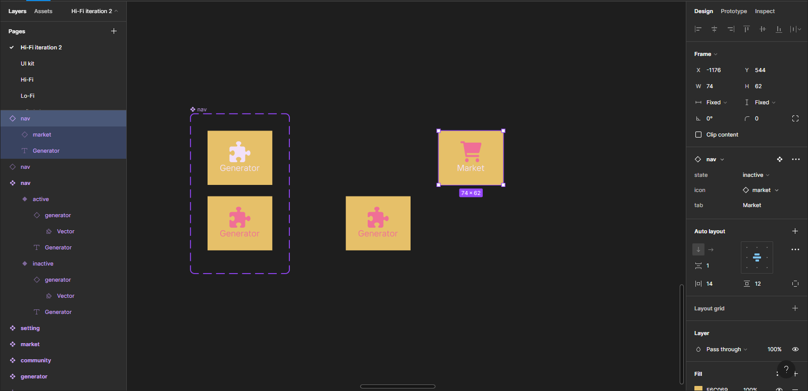

Tarek_Elsayed
Hey @Mojo thank you for the Figma file you provided. It produces the same issue I’m facing.
However the structure in my icons are the same a component that only has one vector
for both the puzzle icon and the cart.
here is an image of the layers :
2022-09-29_201856
Mojo
  • September 29, 2022
@Tarek_Elsayed did you play the proto? for me the union workaround is working, I see the feather going from black to pink when I click, with no issues: Prototype Link 🔗
Tarek_Elsayed
I did play the proto and I saw that it’s working.
How to Union a single shape? I don’t have multiple shapes to union.
