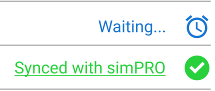

I’d love to be able to apply this interaction to a component within a frame.
For example, I’ve got a series of items that need to upload and then change state after a certain period of time.
An after delay trigger seems perfect for this use case and I can’t see why we should only be able to apply that interaction at the frame level.
Pavel_Kiselev
This is where you can use interactive components. Wrap your stages into a component set and connect variants the way you need in the prototype mode, e.g. after delay
