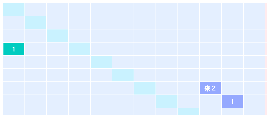

There is no issue on cells white boarder.

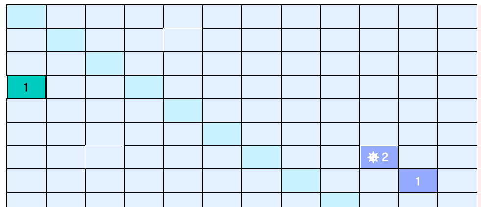

But I open the prototype mode. It shows the black boarder around those cells.

It looks like this in the design board

Make sure the frame has a solid white background. And there should be no decimals in sizes and positions of objects and frames.

I did. I changed the color to other color and then change it back to white. It works in the prototype, but I reopen the prototype again. it did not work and shows me again the black outline.

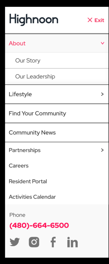

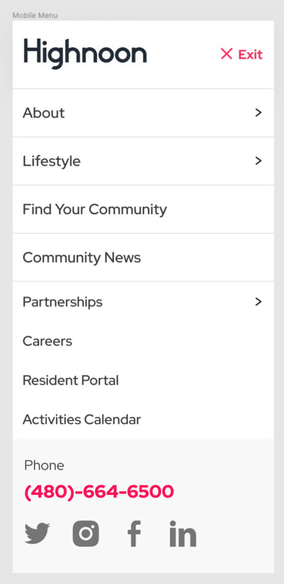

I am having this issue as well. There is no border or shadow on any of my elements in my artboard.
However, in prototype mode it shows.

@Candace_Choi for the parent frame does it have a fill set?
Candace_Choi
It does not.
Josh
  • Former Community Manager
  • 1019 replies
  • January 27, 2022
Got it. If there’s not a fill then the background of the prototype will be shown in any gaps.
You can either add a fill to the parent frame or change the background of the prototype.
