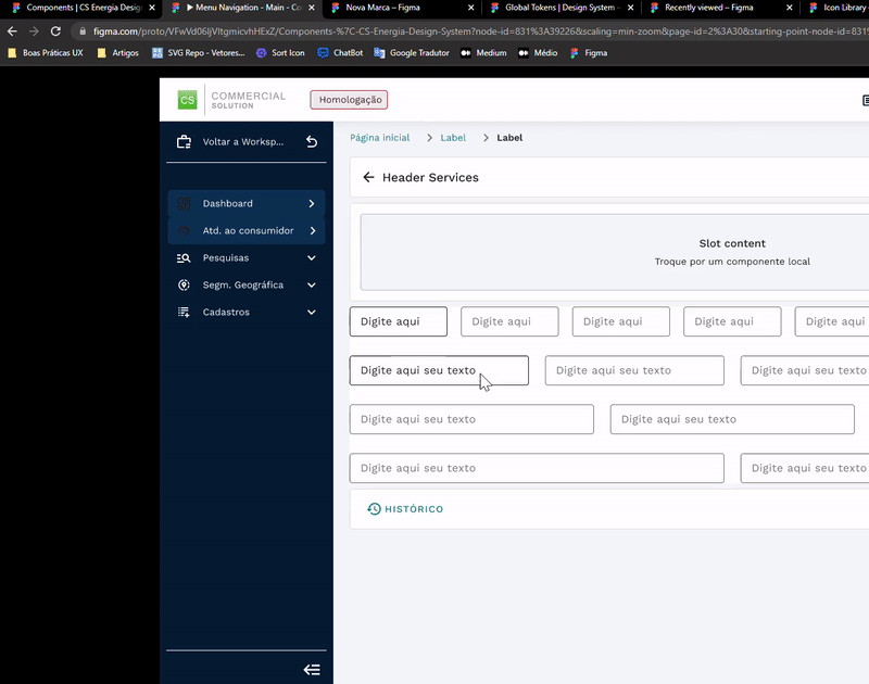

Reloading the Presentation mode tab doesn’t solve the problem?
You can also try using “Mouse enter” and “Mouse leave” triggers instead of “While hovering”.
I also think that you need to report a bug to the support team.
Hello Tank, unfortunately I’ve done it several times and nothing is resolved 😦
On your GIF, I see the hover effect being stuck on elements in the center of the screen. Mouse enter/leave should solve this problem.
I also see that the icons in the menu lose their color override. Do you use the boolean union operation trick to preserve overrides?

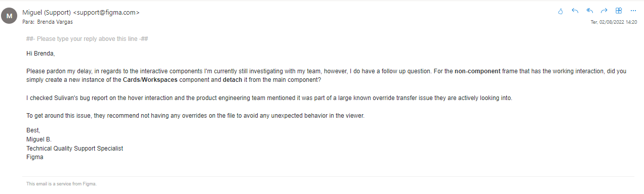

Hi Tank666
I had an answer from Figma about the BUG and I thought it would be interesting to replicate their message here
