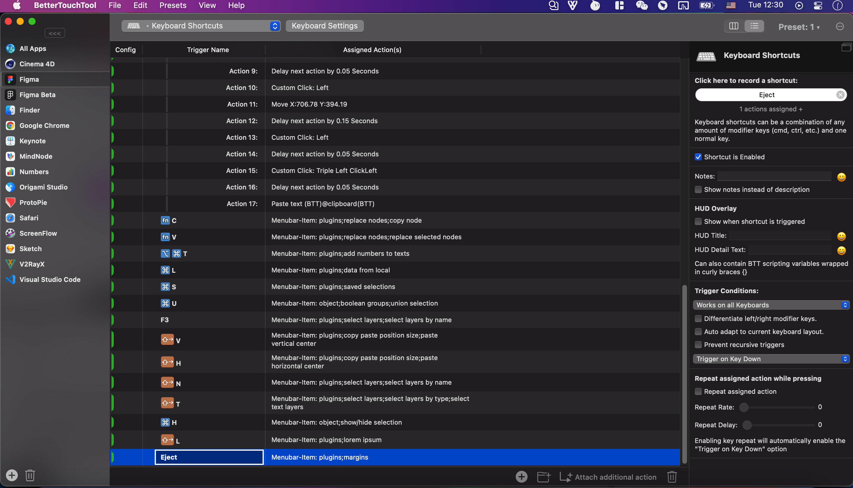

And If you ever feel like you are running out of modifier keys, try these:
  • Use modifier keys on the right side of your keyboard(BTT can differentiate them from their left side counterparts).
  • Use key sequences(e.g. double-pressing ‘m’ key to trigger the minimap plugin).
  • Use letter combinations(e.g. simultaneously press ‘sd’ to ‘auto layout align right’, and ‘mp’ to run ‘master → pick target’).
  • Use mouse draw.

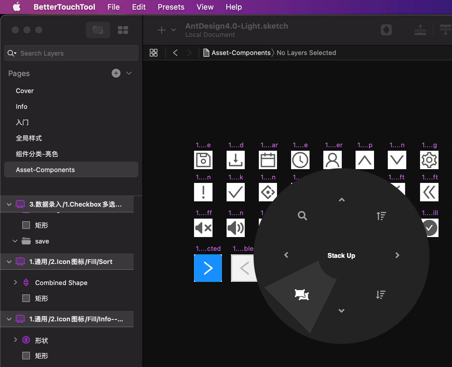

  • Use HTML Floating menus.
    I pieced together this floating menu for Sketch 4 years ago, and it still works perfect.
Tips:
  • remember to attach additional action to press the ‘v’ key at the end, if your chosen keypress happens to activate certain tools.
  • You can use the Eject⎋ key, the fn key, and the Tab⇥ key to further expand your arsenal.
