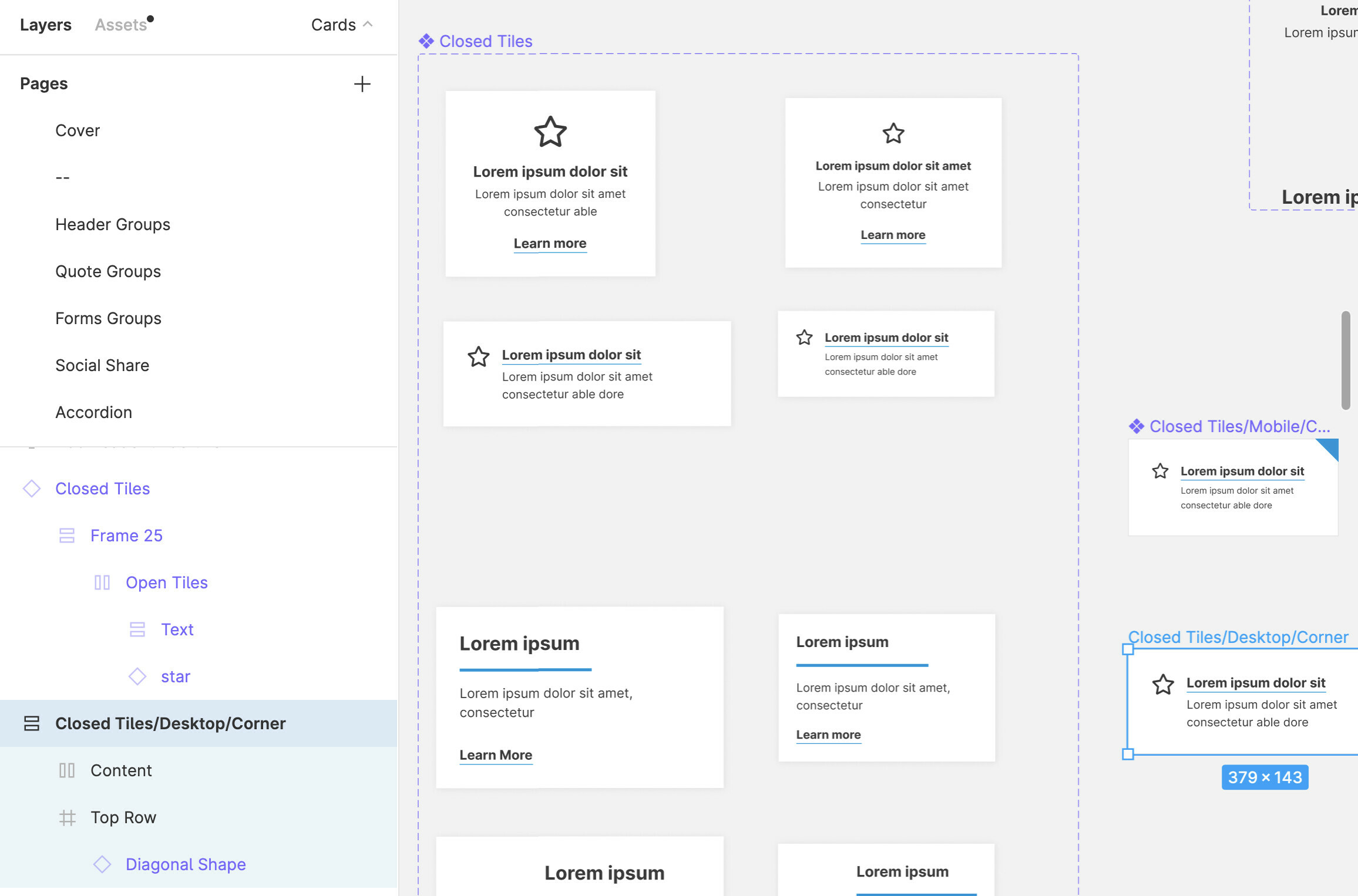

Hi, I need help adding a variant to an existing component set. The new component has a slightly different frames organization within it to accommodate the corner marking. I’ve named the new, corner-marked component with the slash naming convention, selected both it and the component set I would like to add it to, but I don’t see “Combine as Variants” as an option. Can anyone assist with next steps?

Combine as Variants works when two or more components are selected. You can see in your first screenshot that one object is not a component. And the second screenshot, unfortunately, did not load.
If you need to add the component that is visible in the screenshot to an existing Component Set, then just drag it into the frame of this set or move this component to the Component Set on the Layers Panel.
