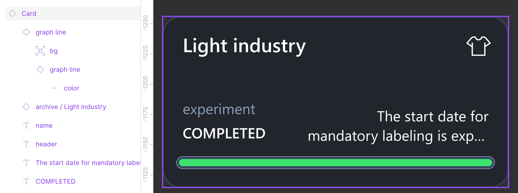

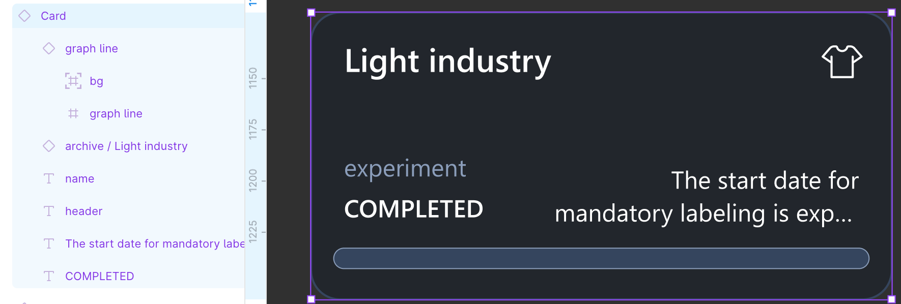

I made uikit, published the library, and started using it in another file. Unfortunately, the component has magically changed, which greatly complicates the work

Hi ​@Aleksandra Kormashova,
I've had a look at the pictures you shared, and I see the difference in how the nested objects appear in your layers panel.
I want to make sure I understand correctly: are those two “Card” instances from the same main component, but they look different in your file(s)?
Could you please double-check if they're from the same main component by using the "Go to main component"? Here’s the detailed instruction: Find main components
If they are from the same main component, please let us know.
In that situation, our support team would likely need to review both the library file and the file(s) where the instances are placed to understand what might be happening.
