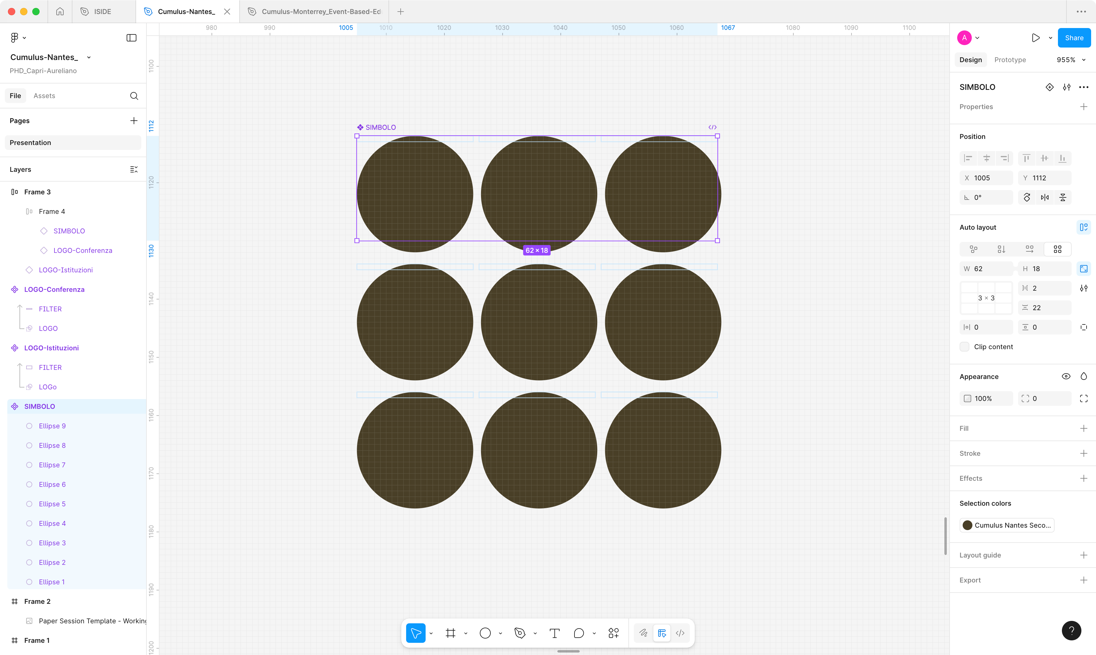

Hi,
I am trying to use the new function “GRID” into AutoLayout setting.
AS you can see from my image, the component “SIMBOLO” is made by 9 circles, I can easily set the padding between them, and it’s ok.
But WHY does the height not fit to the contents?
I cannot set HUG contents both. on Height nor Width.
This cause a problem in using the istance for misalignment in over-nesting autolayout, as an example.
Thank you for the attention
Have a good weekend!
Aureliano_Capri2
I add a comment: the new function GRID is totally unclear and not consistent in the feedback given by the UI, it’s “ruining” Autolayout function.
