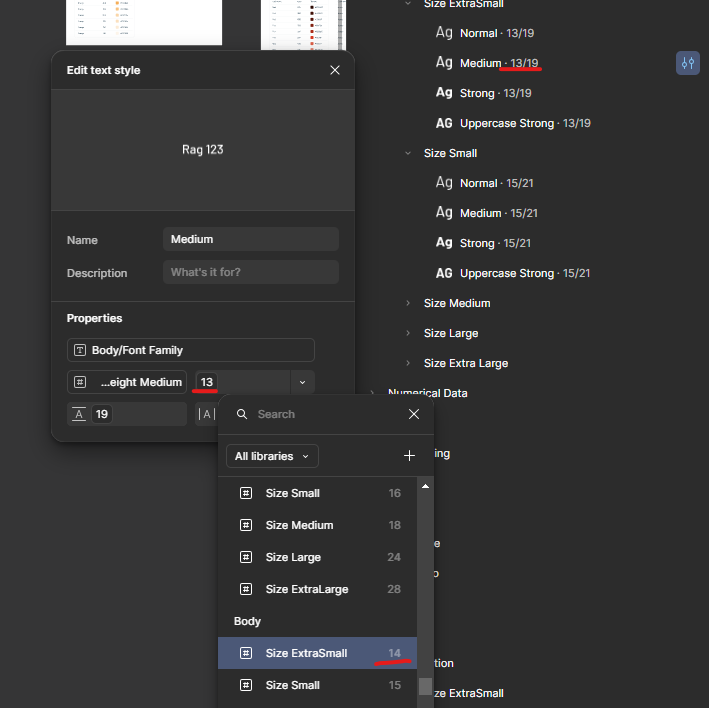

I'm experiencing a problem with the font size not rendering as expected.

Bug Report for Figma: Variable Font Size Display Mismatch
Hi Figma team, ​@Junko3
I'm still encountering a persistent issue related to font size display and number variables, even after following the troubleshooting steps you previously suggested:
  • I've force-quit both the browser and desktop app sessions and restarted.
  • I've re-set the affected variable.
  • I've verified that other variables display correctly.
  • I've confirmed the variable is created within the file (not from an external library).
  • The Libraries Picker and Variables modal display the same values.
However, the problem persists.
šŸ” Description of the Issue:
There seems to be a discrepancy between the displayed font size in the Text Style properties and the actual number variable value assigned in different modes.
For example:
  • In Mode A, the header text size is set to 17.
  • In Mode B, the header text size is set to 18.
But when I apply the variable to a text element and switch to Mode B, the Text Style panel still shows 17 instead of 18. It appears that the displayed value is stuck to the first mode (Mode A), and doesn't update based on the currently active mode.
This creates confusion when managing designs with multiple modes (e.g., for themes, devices, or brands), as the text style panel doesn't accurately reflect the live value from the active mode.
āœ… Expected Behavior:
When switching modes, the font size shown in the Text Style properties should reflect the value assigned to the variable in the active mode, not the default or initial mode.
Let me know if you need a sample file or screen recording — I’d be happy to provide it.
Thanks!
