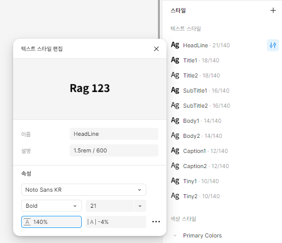

Upon understanding that the problem stemmed from the line height information of the Noto Sans font changing due to the font update, we addressed it by adjusting our existing font styles.
For those who might be encountering the same problem, we'd like to share how we solved it. It's a straightforward approach, but hopefully useful for reference:
_____
Previously, we were using 'auto' line height in our Figma font styles.
We confirmed that in our actual development environment, line-height: 1.4 was applied to all fonts. So, we changed the line height for all Figma font styles to '140%'.
Publishing the styles with 140% line height allowed us to revert the line height to be similar to how it was before the font update.
_____
Hope this helps!
